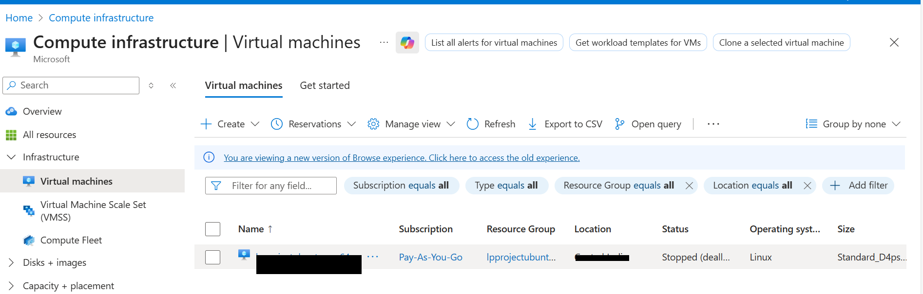

- Navigate to the Azure portal , go to Virtual Machines, and select your virtual machine.
Azure Virtual machines page

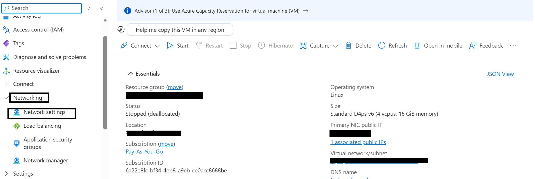

- In the left menu, select Networking, then select Network settings.
Azure VM networking settings

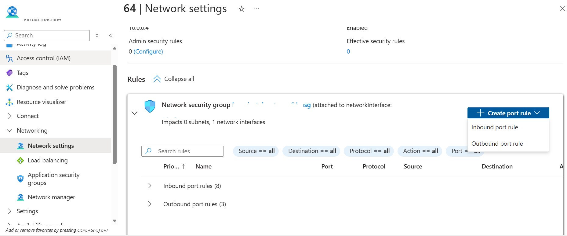

- Navigate to Create port rule, and select Inbound port rule.
Create inbound firewall rule
