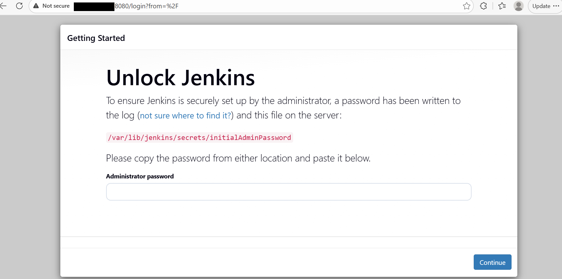

Complete the initial Jenkins setup using the web interface:
Paste the initial admin password saved previously.

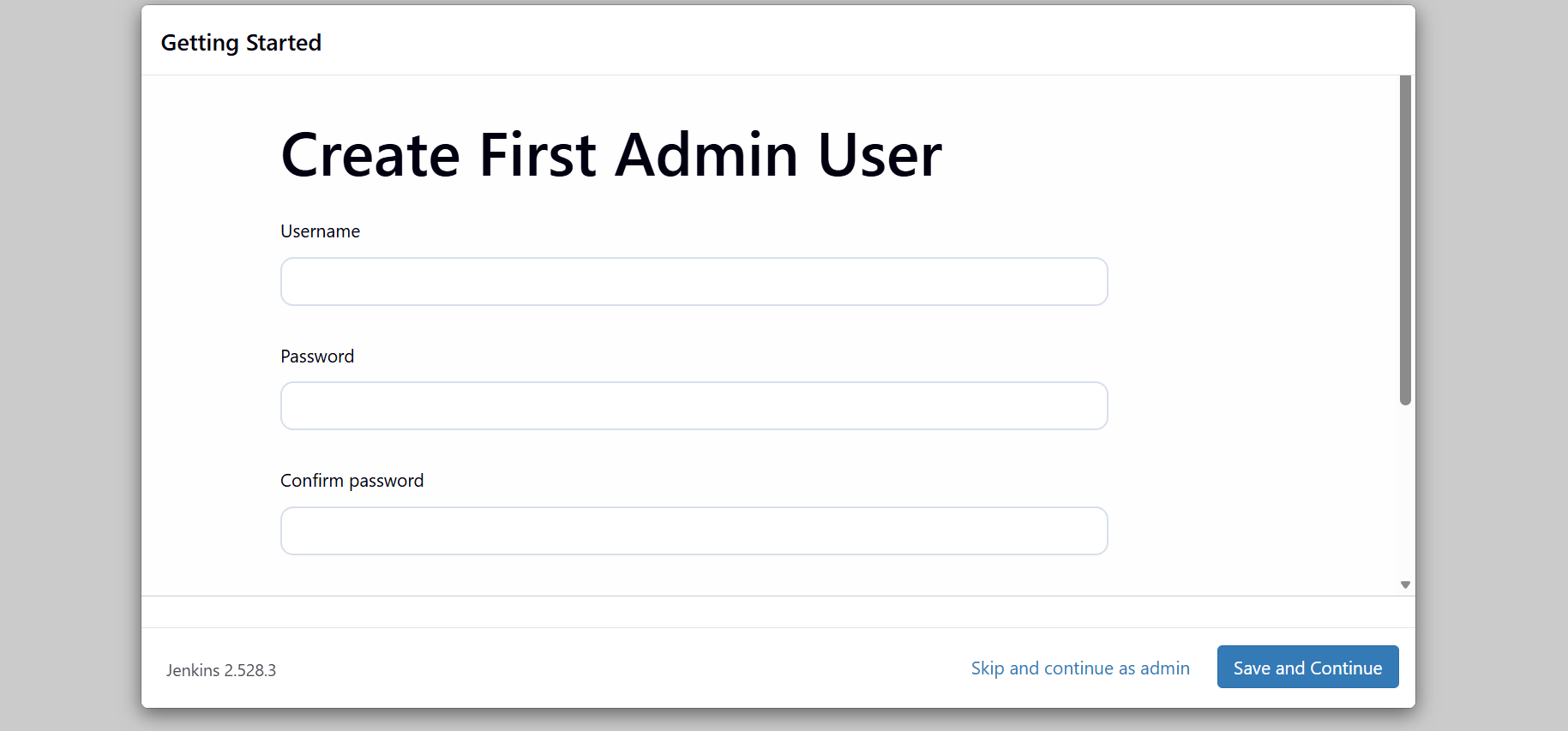

Create an admin user.
Image Alt Text:Jenkins user creation form with fields for username, password, full name, and email address alt-txtCreate admin user
Finish setup and reach the Jenkins dashboard.

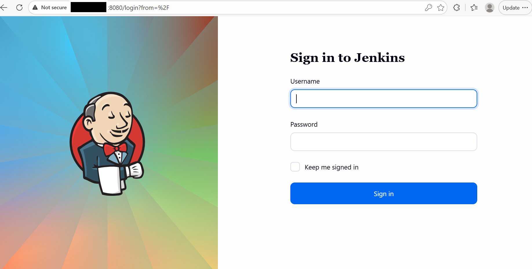

Log in using your Jenkins credentials:
Image Alt Text:Jenkins login screen with username and password fields and Sign in button alt-txtJenkins login page

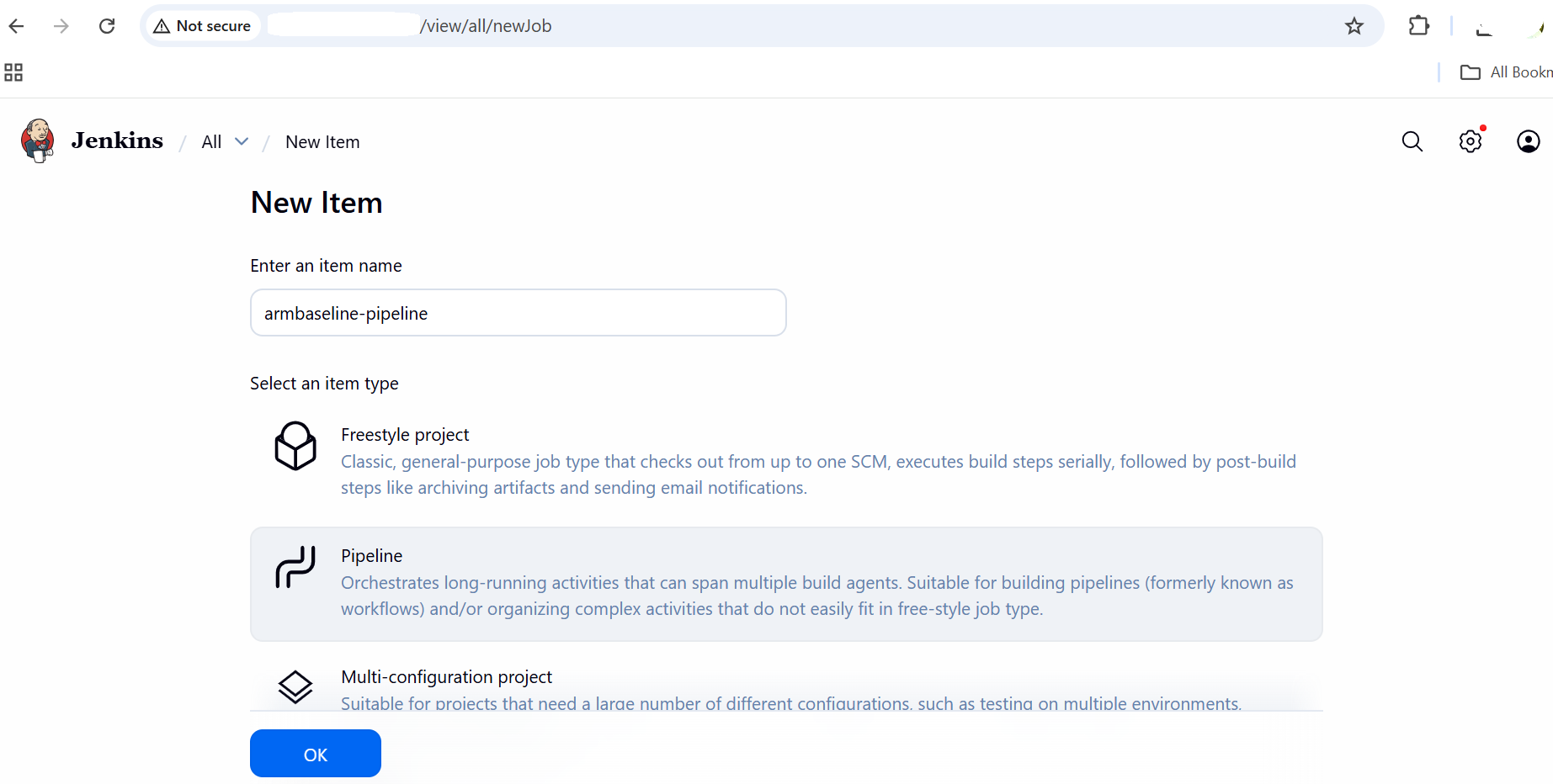

Create a new pipeline job
Create a basic pipeline job to validate execution capability:
  • Click New Item (left sidebar).
  • Enter item name: armbaseline-pipeline.
  • Select Pipeline.
  • Select OK.
Image Alt Text:Jenkins New Item page showing item name field with armbaseline-pipeline entered and Pipeline option selected alt-txtCreate new pipeline item

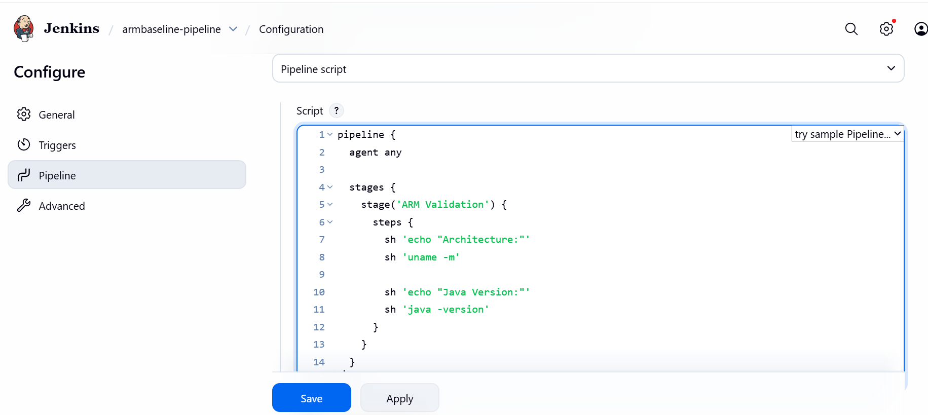

Add the pipeline script
Configure a simple pipeline to validate Arm architecture and Java availability.
Scroll to the Pipeline section:
  • Definition: Pipeline script
Paste the following script:
pipeline {
  agent any
  stages {
    stage('Arm Validation') {
      steps {
        sh 'echo "Architecture:"'
        sh 'uname -m'
        sh 'echo "Java Version:"'
        sh 'java -version'
Select Save.
Image Alt Text:Jenkins pipeline configuration page showing Pipeline script definition section with Groovy code visible alt-txtCreate pipeline

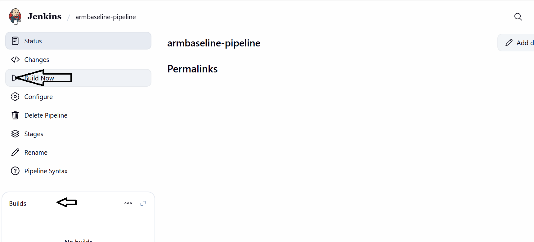

Run the pipeline
Trigger the pipeline execution:
  • On the job page, select Build Now.
  • A build number appears under Build History.
Image Alt Text:Jenkins pipeline job page showing Build Now button in left sidebar and build #1 appearing in Build History alt-txtRun pipeline
