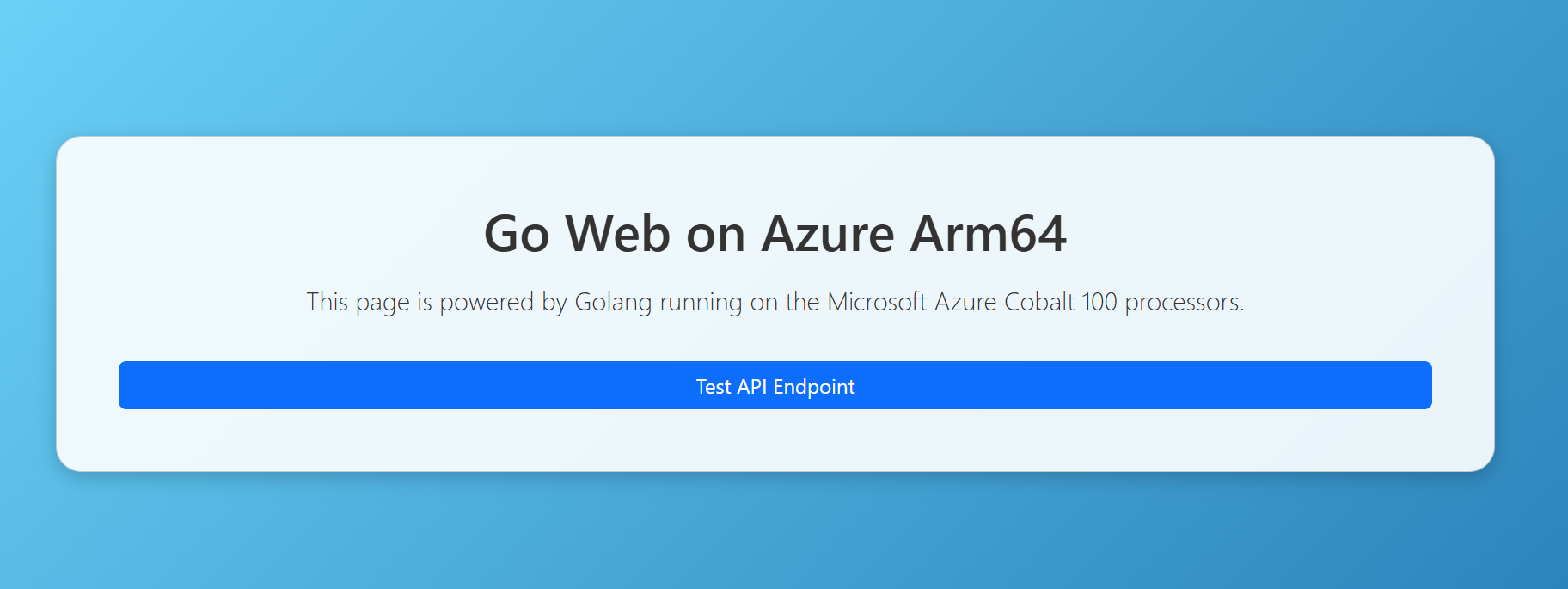

Open the site in a browser
Print your VM’s public URL:
echo "http://$(curl -s ifconfig.me)/"
Open this URL in your browser. You should see the styled HTML landing page served by your Go application.
Image Alt Text:Go web server running on Azure Cobalt 100 Arm64 alt-textGo web server running on Azure Cobalt 100 Arm64
Baseline Testing Complete
Successfully reaching this page confirms:
  • Go toolchain is properly installed and configured
  • Development environment is ready for Arm64 compilation
  • Network connectivity and firewall configuration are correct
  • Runtime performance is functioning on Azure Cobalt 100 processors
