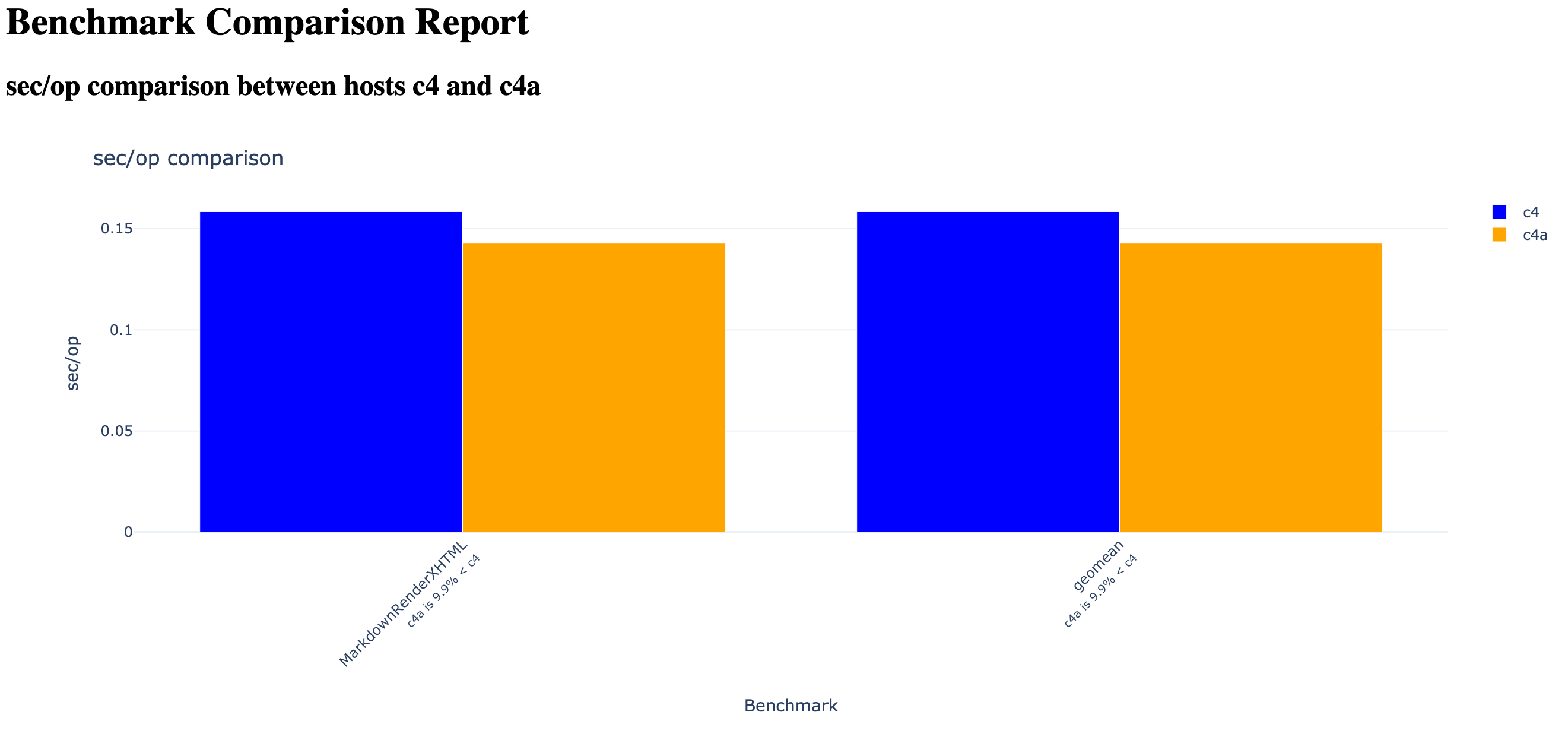

View the report
Once on your local machine, rexec_sweet will generate an HTML report that opens automatically in your web browser.
If you close the report, you can reopen it by navigating to the results subdirectory and opening report.html in your browser.
Image Alt Text:alt-textSample HTML report
Note
If you see output messages similar to “geomeans may not be comparable” or “Dn: ratios must be >0 to compute geomean”, this is expected and can be ignored. These warnings typically appear when benchmark sets differ slightly between the two VMs.
Upon completion, the tool generates a report in the results subdirectory of the current working directory, which opens automatically in your web browser to view the benchmark results and comparisons.
