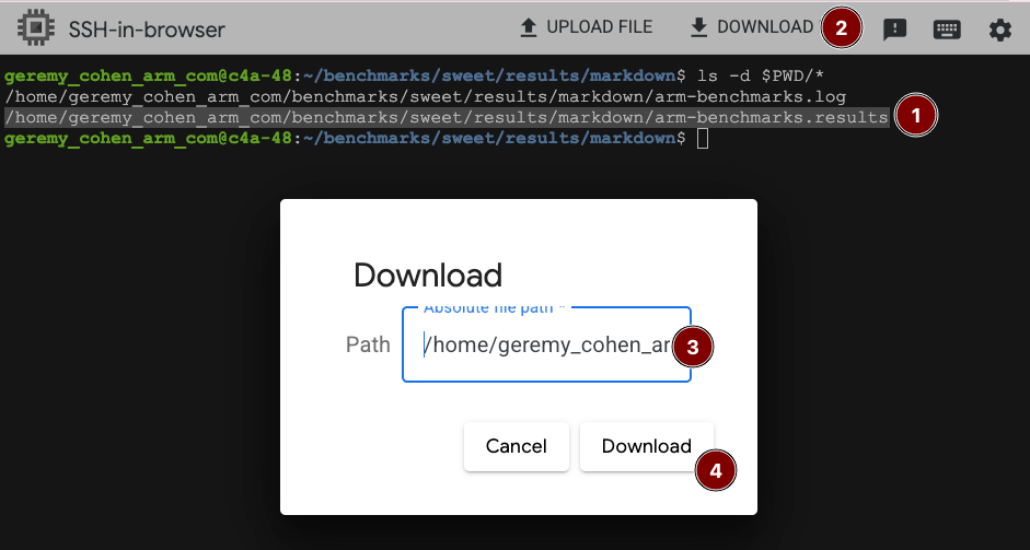

Start by retrieving the results generated by Sweet from your earlier benchmark runs.
Change directory to the results/markdown directory and list the files to see the arm-benchmarks.result file:
cd results/markdown
ls -d $PWD/*
Copy the absolute pathname of arm-benchmarks.result. You’ll need this to initiate the download.
Select DOWNLOAD FILE in your GCP terminal interface. Paste the absolute pathname you copied into the dialog and confirm the download. This downloads the benchmark results to your local machine.
Download the results

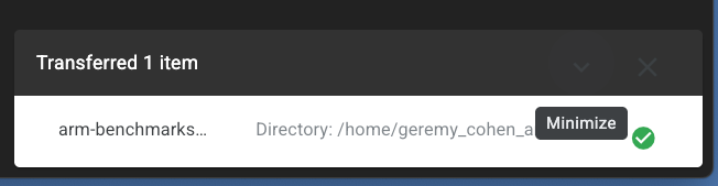

After downloading the file to your local machine, rename it to c4a.result to distinguish it from the x86 results you’ll download next. This naming convention helps you clearly identify which architecture each result came from. You’ll know the download was successful if you see the file named c4a.result in your Downloads folder and receive a confirmation in your browser.
A successful download
