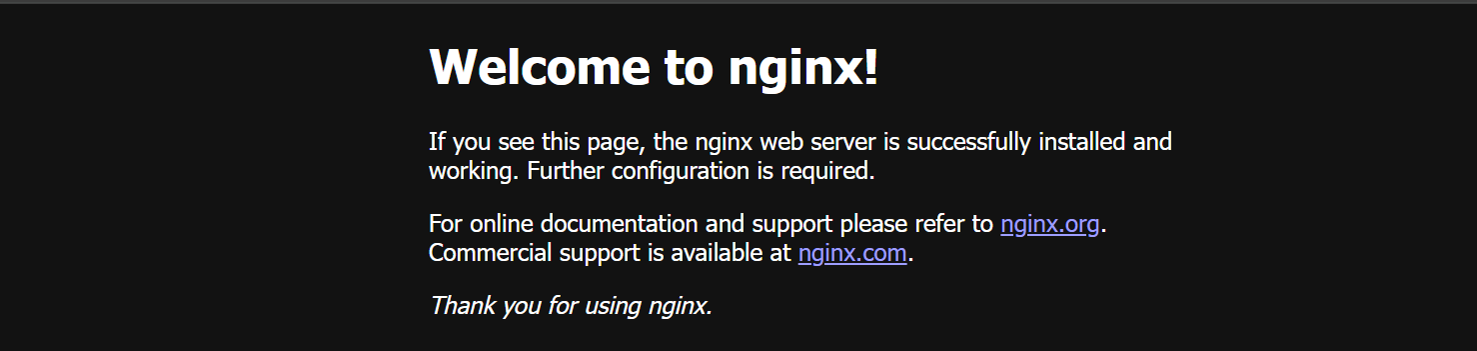

Once the workflow completes, open your browser and navigate to your machine’s external IP address. You will find the information in your instance overview, under Network interfaces.
http://<your-public-IP>
You should see the NGINX welcome page confirming a successful deployment.
Screenshot of the NGINX welcome page in a browser
