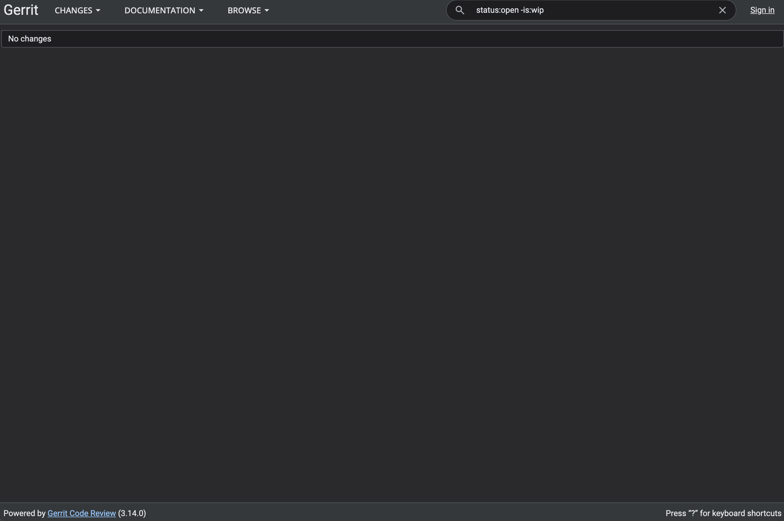

## Confirm that the Gerrit dashboard is accessible
Navigate to the following URL in a browser of your choice, replacing `my_vm_public_ip` with the public IP address of your VM instance:
__output__
http://my_vm_public_ip_address:8080
You’ll see the following dashboard:
![Gerrit dashboard](https://learn.arm.com/learning-paths/servers-and-cloud-computing/gerrit-on-gcp/images/gerrit-dashboard.png)
*Gerrit dashboard*
