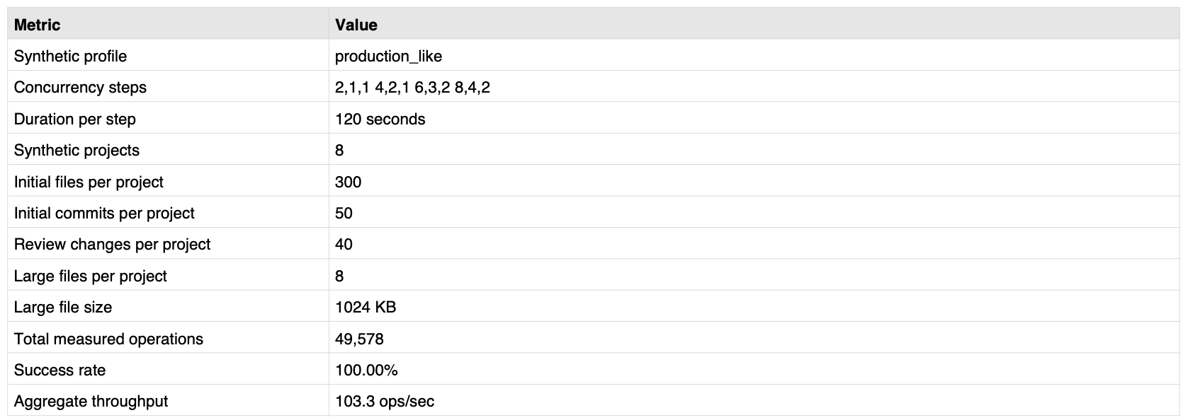

The benchmark run completed successfully on the production-like profile with Gerrit metrics enabled. It recorded 49,578 measured client operations over four 120-second steps, with 49,578 successes and zero failures.
The benchmark gives a high-quality performance view: client latency, stepwise concurrency behavior, node CPU/memory/disk. Gerrit-side JVM, GC, Jetty, cache, queue, Git, REST, NoteDB, and receive-commits metrics are all present:
![Gerrit benchmark summary](https://learn.arm.com/learning-paths/servers-and-cloud-computing/gerrit-on-gcp/images/analysis.png)

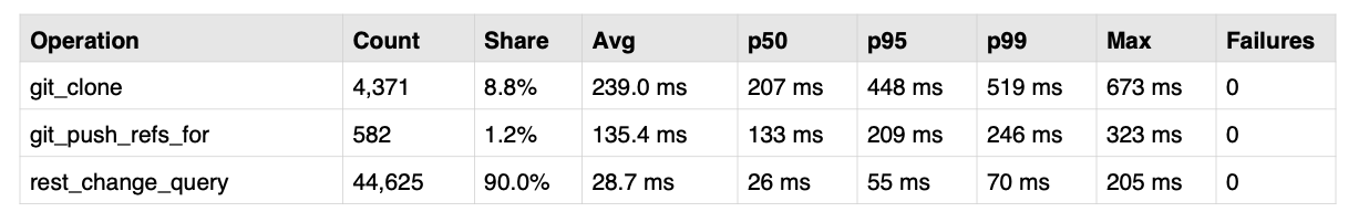

All 49,578 measured client-side operations succeeded. REST query latency remains low with a p99 of 70 ms. Clone is the dominant pressure point at a p99 of 519 ms, and push remains sub-second at a p99 of 246 ms:

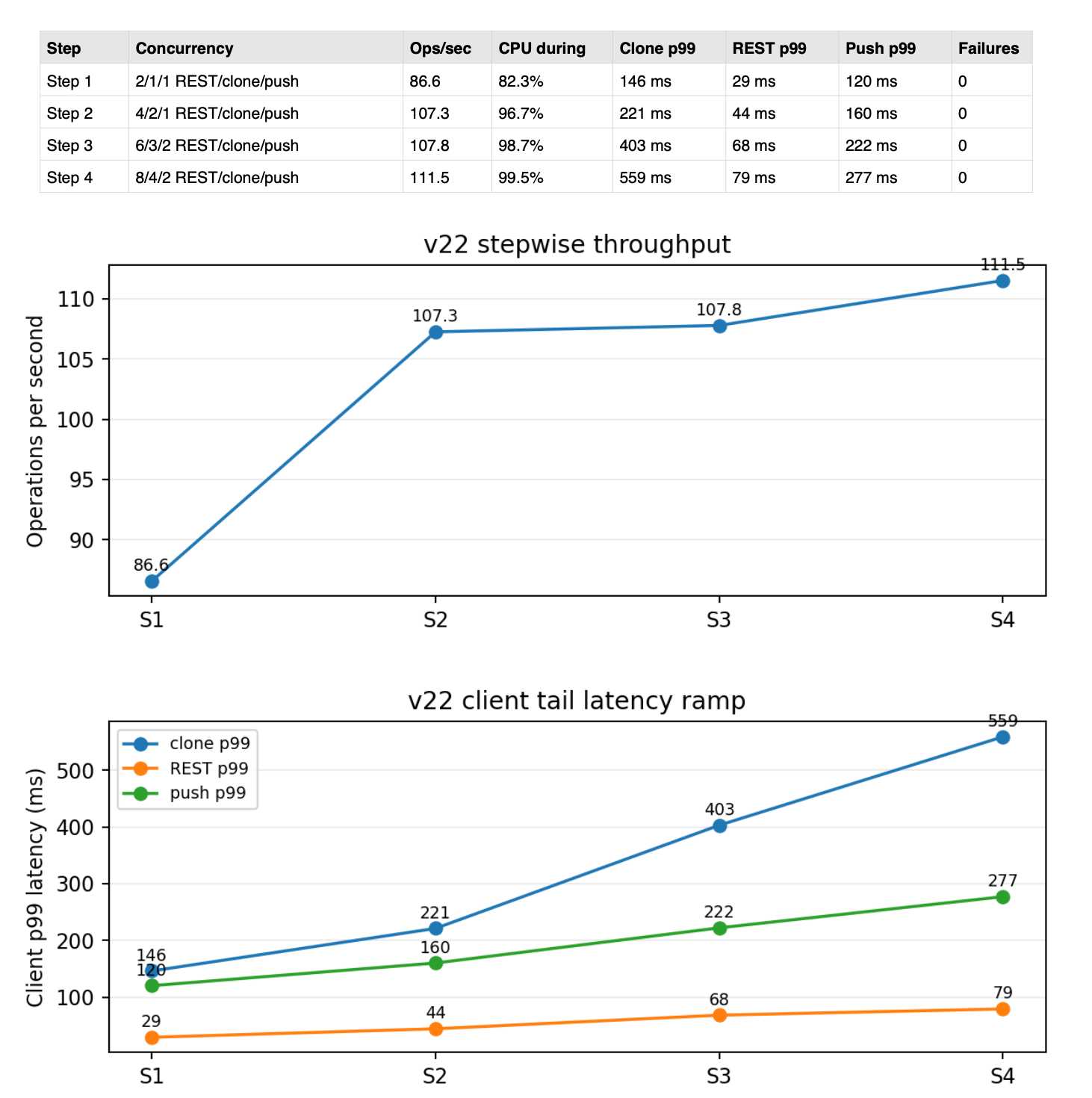

The useful capacity signal is the flattening throughput curve after step 2. CPU is already near saturation in step 2 at 96.7%, then rises to 99.5% in step 4. Latency continues rising: clone p99 increases from 221 ms in step 2 to 559 ms in step 4, while aggregate throughput only rises from 107.3 to 111.5 ops/sec:
![Stepwise concurrency behavior summary](https://learn.arm.com/learning-paths/servers-and-cloud-computing/gerrit-on-gcp/images/stepwise-summary.png)

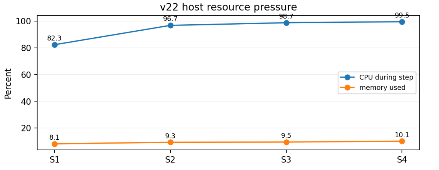

The following chart shows host CPU pressure:

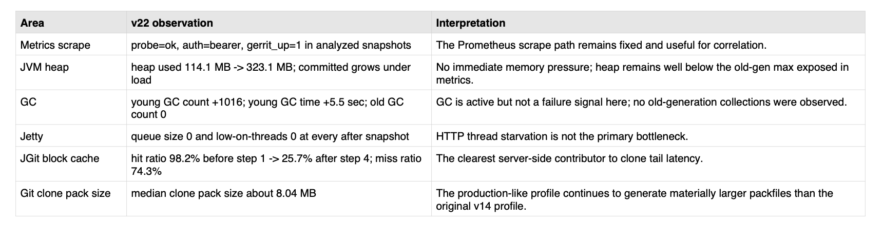

The following table lists Gerrit server-side correlation observations:
![Gerrit server-side correlation findings](https://learn.arm.com/learning-paths/servers-and-cloud-computing/gerrit-on-gcp/images/gerrit-correlation.png)

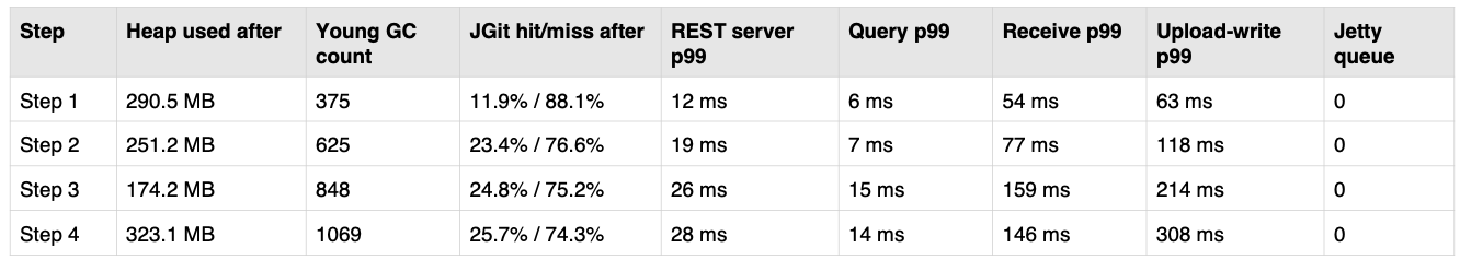

The following table lists server metrics:
![Basic additional server metrics](https://learn.arm.com/learning-paths/servers-and-cloud-computing/gerrit-on-gcp/images/server-metrics.png)
