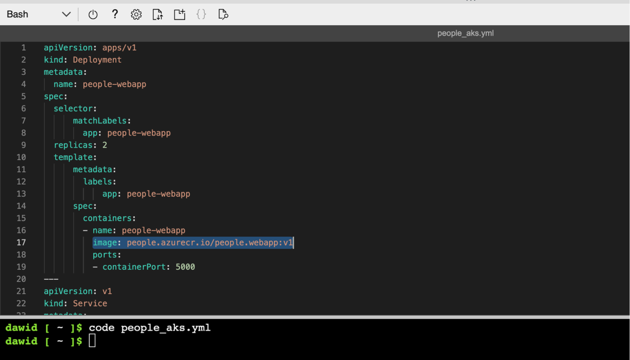

  1. To edit the file, you type:
code people_aks.yaml
  1. This will open the code/text editor in Azure:
Image Alt Text:AKS#left
  1. Check line number 17. In our case, it points to the fully qualified container image name, image: people.azurecr.io/people.webapp:v1. This includes the container registry login server, image name, and image tag. The login server is the same one we created in part 2 of this learning path series. If you use a different name for either the container registry or the container name, update line 17 correspondingly. Then save the changes to the same file, people_aks.yml (CTRL+S), and close the editor (CTRL+Q).

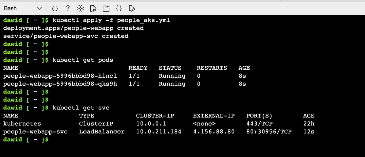

  2. To deploy the workload, type the following command in the Cloud Shell:
kubectl apply -f people_aks.yml
It will take a few moments to deploy the workload. Then, use the following command to display the list of pods:
kubectl get pods
Ensure the status of each pod is running. Then type:
kubectl get svc
This will display the list of services as shown below:
Note the IP address under the EXTERNAL-IP column of people-web-appsvc. That is the Public IP where you can find your application. In my case, that is 4.156.88.80. By typing this IP in the web browser, you will see an application up and running:
