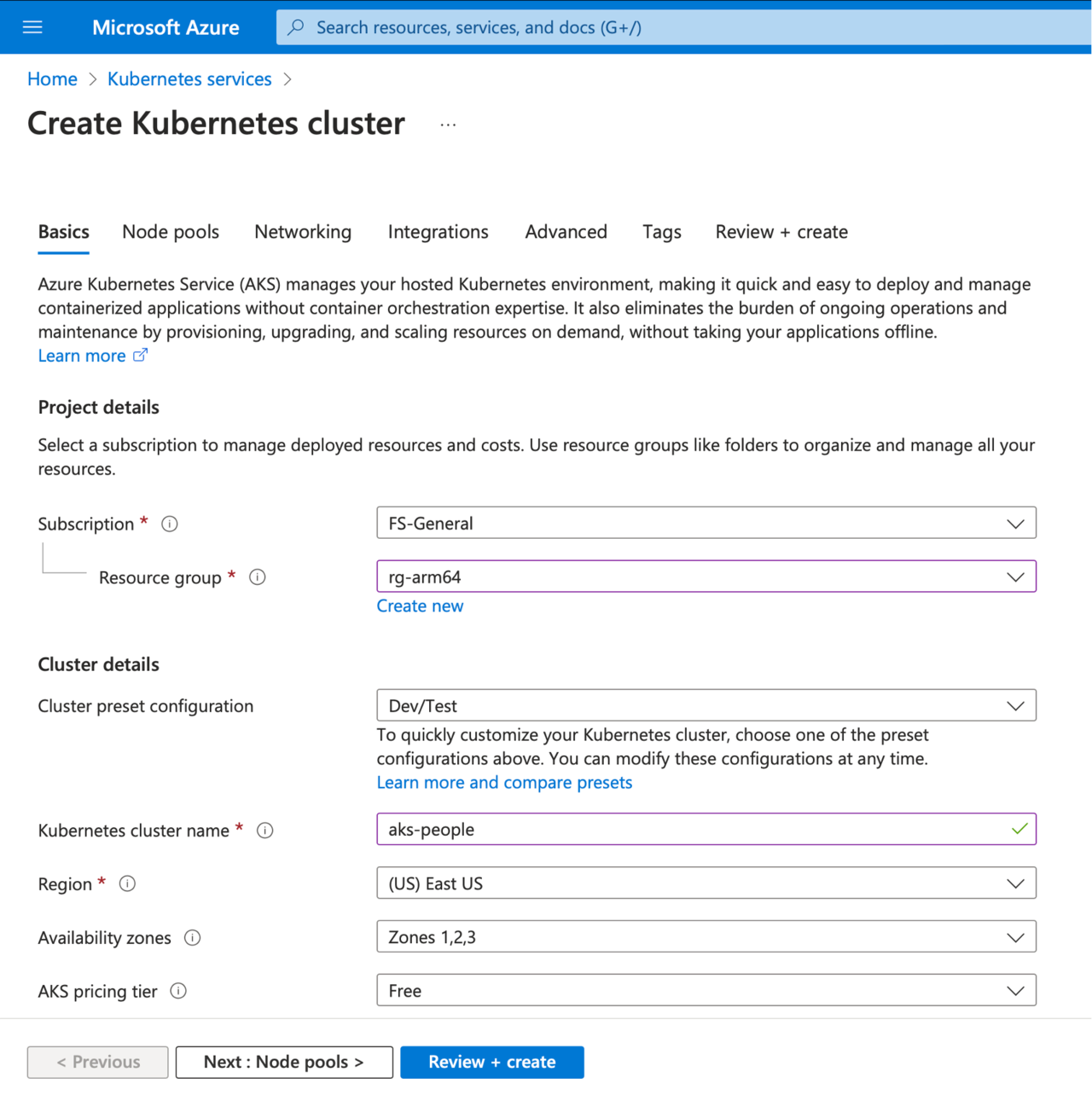

The previous step will activate the Create Kubernetes cluster wizard, which you use to configure your cluster as follows:
- Subscription: select your subscription
- Resource group: rg-arm64
- Cluster preset configuration: Dev/Test
- Kubernetes cluster name: aks-people
- Region: US East (or any other region)
- Availability Zones: Select all (if available). Otherwise, keep the default setting.
- AKS pricing tier: Free
- Kubernetes version: default (here that is 1.26.6)
- Automatic upgrade: Enabled with patch (recommended)
- Authentication and Authentication: Local accounts with Kubernetes RBAC
At this point, your configuration should look as follows:

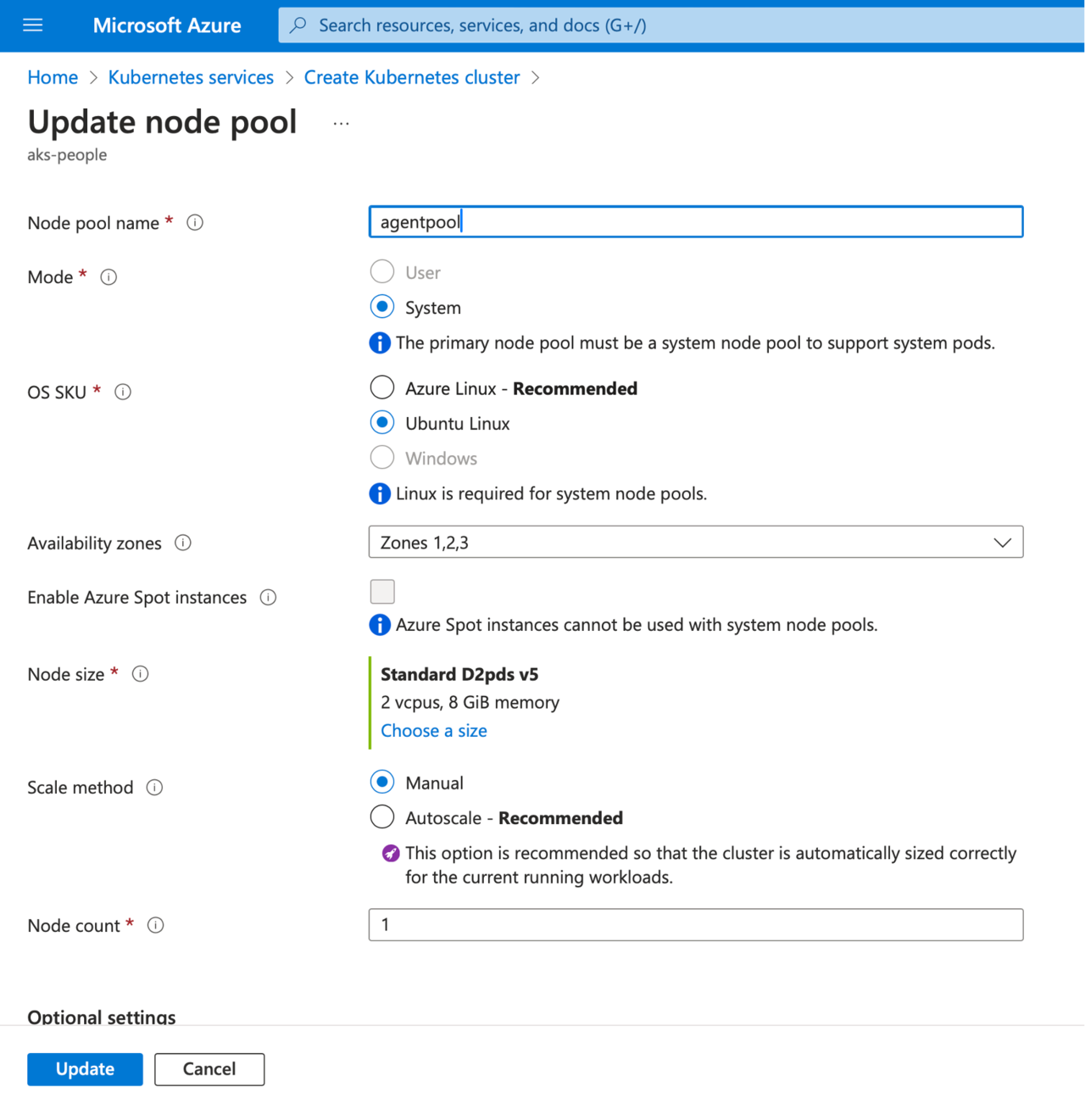

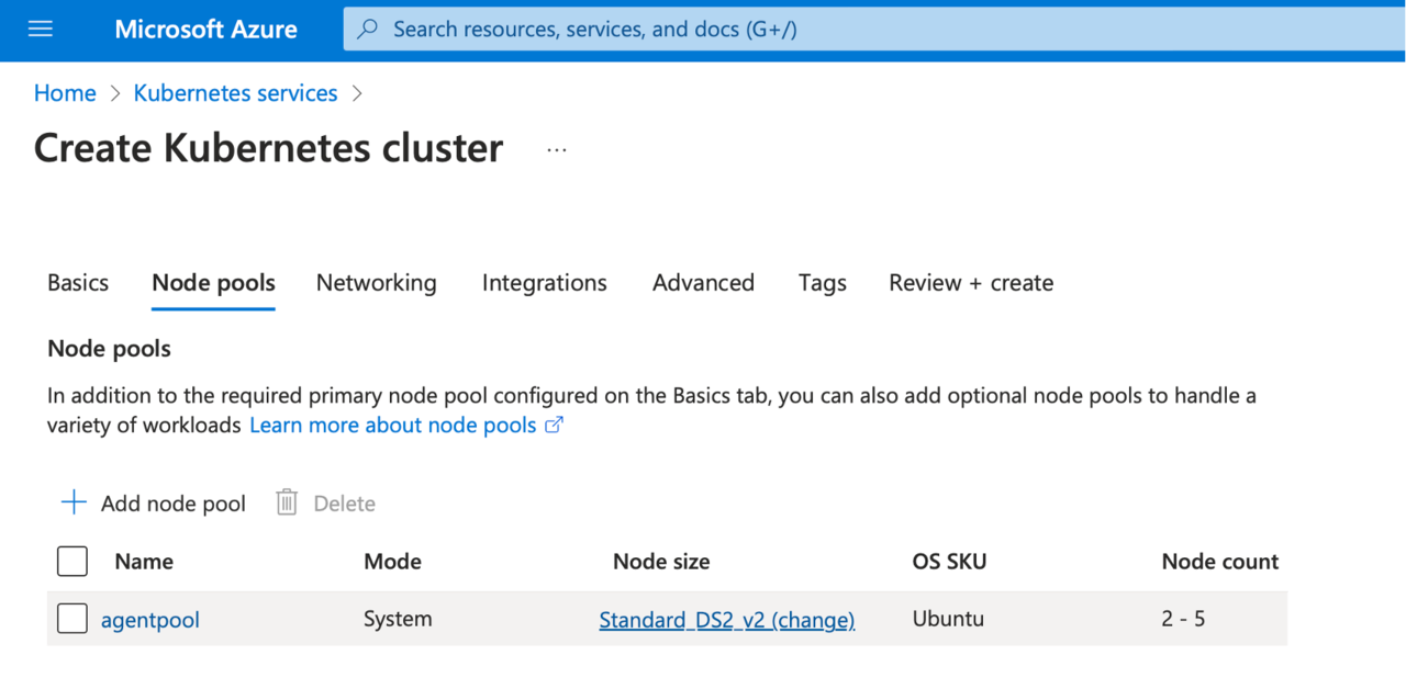

Click Next: Node pools >. This will open the Node pools tab. Under the Node pools tab, click the hyperlink Standard DS2_v2 (change) under the Node size column of the agent pool:
You will see the Update node pool wizard, in which you do the following:
- Under the Scale method, select Manual
- Set Node count to 1
- Click Choose a size under the Node size

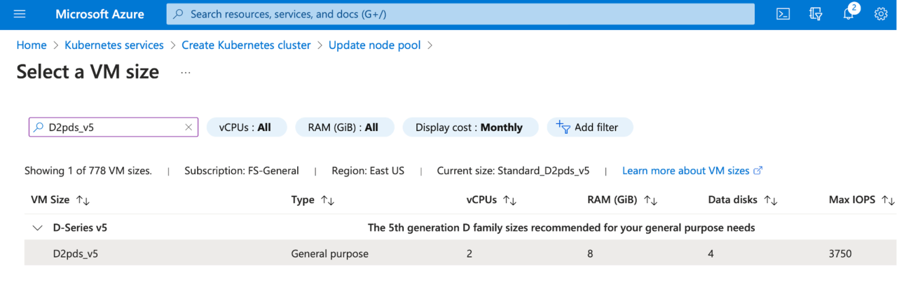

- This will open Select a VM size screen, where you look for D2pds_v5 VM (the arm64-based VM you used in the first part of this learning series).
- Click the Select button
Your Update node pool wizard should look as follows:

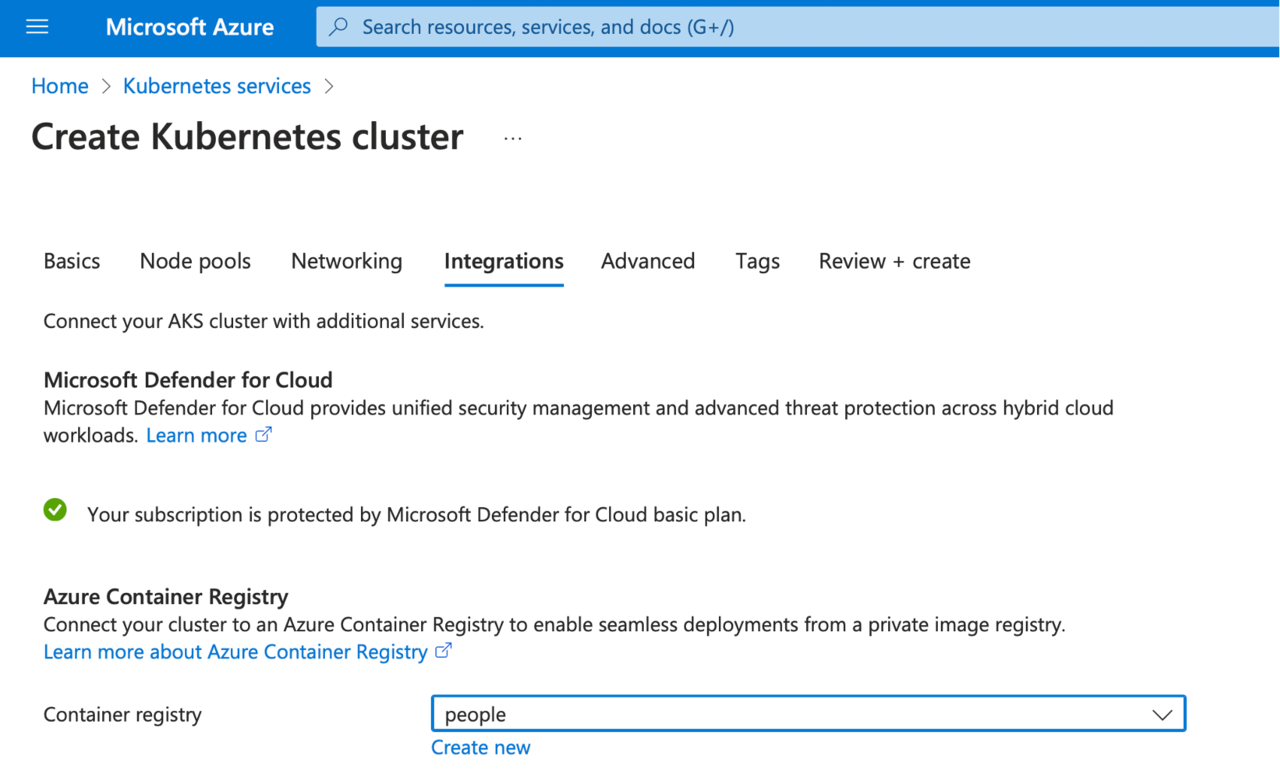

Under integrations, look for the Container registry and select people (or your Azure Container Registry, if you used a different name):

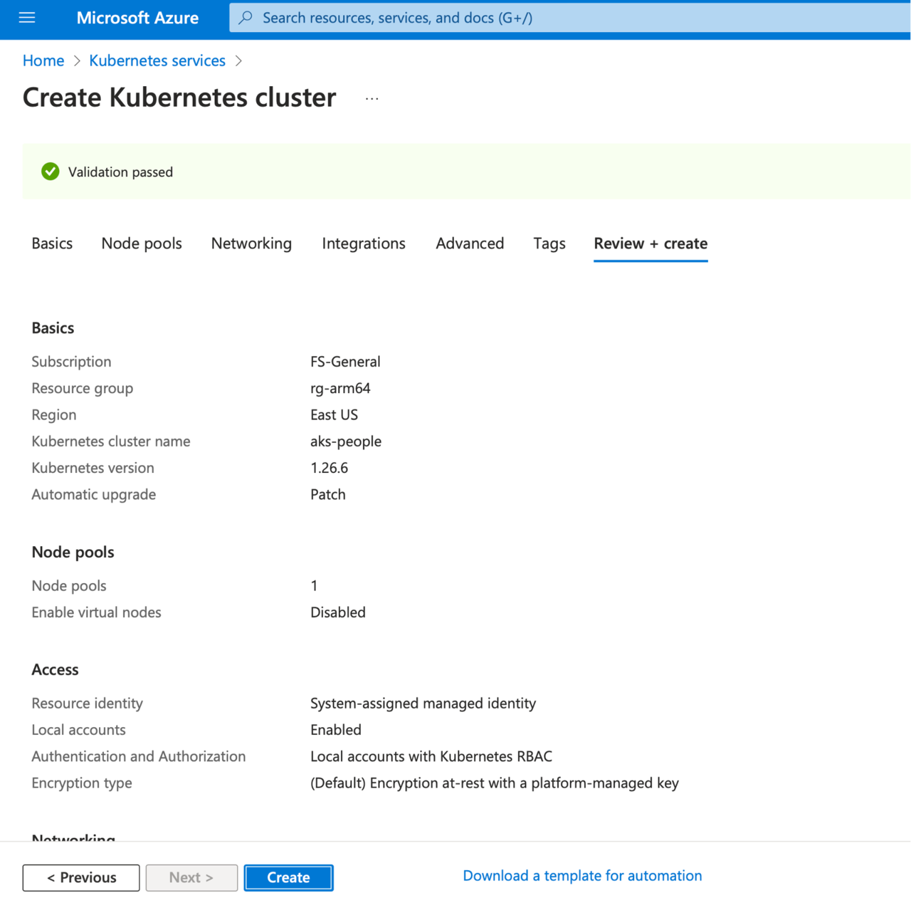

Finally, click the Review + create button and wait for the validation to complete. Then, click the Create button:
Wait a few moments for the cluster to be deployed, and in the confirmation screen, click the Go to resource button.
