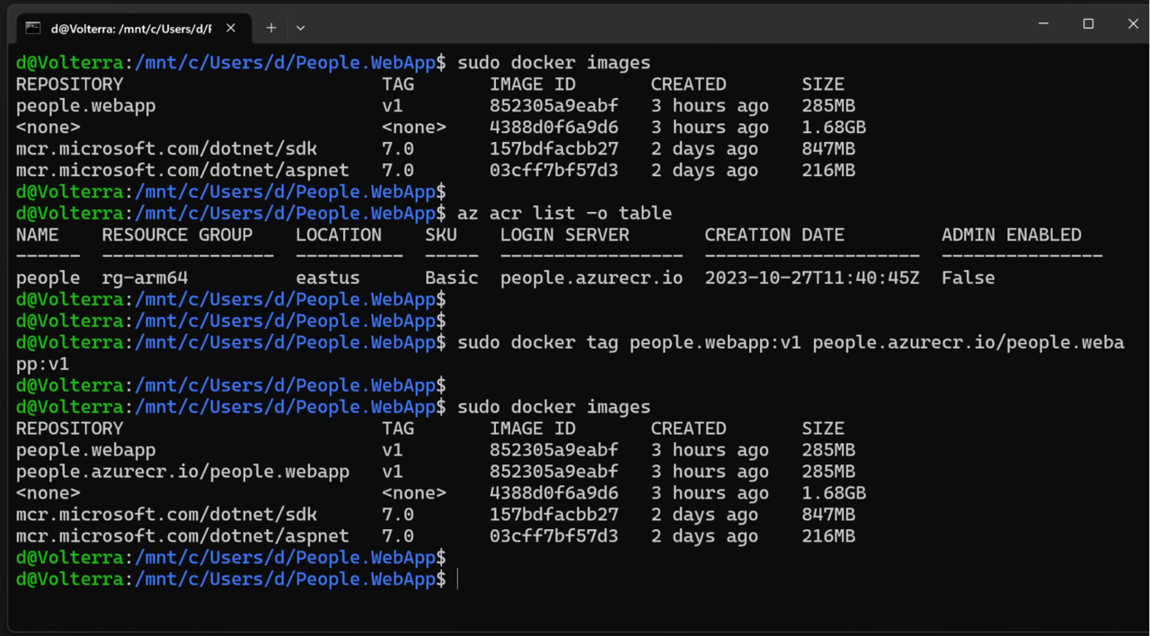

### Pushing the local image to Azure
Start by opening the WSL console, where you type:
```bash
sudo docker images
This command will display the list of local Docker images (we display this to have all the necessary information, like the image name and tag available). Then, we need to tag the local image with the fully qualified name of the container registry (login server) we created in Azure. To display the fully qualified name of the registry, we type:
```bash
az acr list -o table
Subsequently, we tag the image using the login server:
```bash
sudo docker tag people.webapp:v1 people.azurecr.io/people.webapp:v1
The last command does not provide any output. To ensure the local image was correctly tagged, we type (Figure 22):
```bash
sudo docker images
![Figure 22. Tagging a local Docker image](https://learn.arm.com/learning-paths/servers-and-cloud-computing/from-iot-to-the-cloud-part1/figures/22.webp)

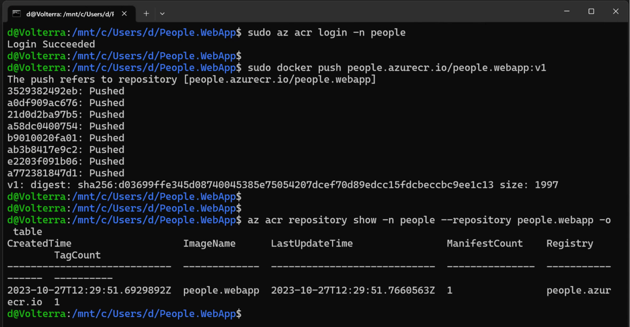

Finally, we push the image to the remote registry. We proceed as follows:
1. In the WSL terminal, we type:
   ```bash
   sudo az login
2. Then open [https://microsoft.com/devicelogin](https://microsoft.com/devicelogin) and use the code provided by the above command.
3. Login to Azure Container Registry:
   ```bash
   sudo az acr login -n people
4. Push the image:
   ```bash
   sudo docker push people.azurecr.io/people.webapp:v1
To confirm the image was pushed, type:
```bash
az acr repository show -n people --repository people.webapp -o table
The output from the commands above is shown here:
![Figure 23. Pushing a Docker image to the Azure Container Registry](https://learn.arm.com/learning-paths/servers-and-cloud-computing/from-iot-to-the-cloud-part1/figures/23.webp)
