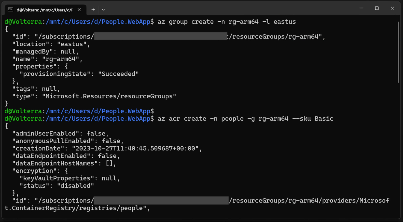

  2. Now create the resource group name rg-arm64 with a default location set to EastUS:
az group create -n rg-arm64 -l eastus
  1. Create the Azure Container Registry of name people in the rg-arm64 group using the Basic pricing tier:
az acr create -n people -g rg-arm64 --sku Basic
The output of the above commands will look as shown below: Image Alt Text:command prompt#leftFigure 20. Creating the Azure Container Registry

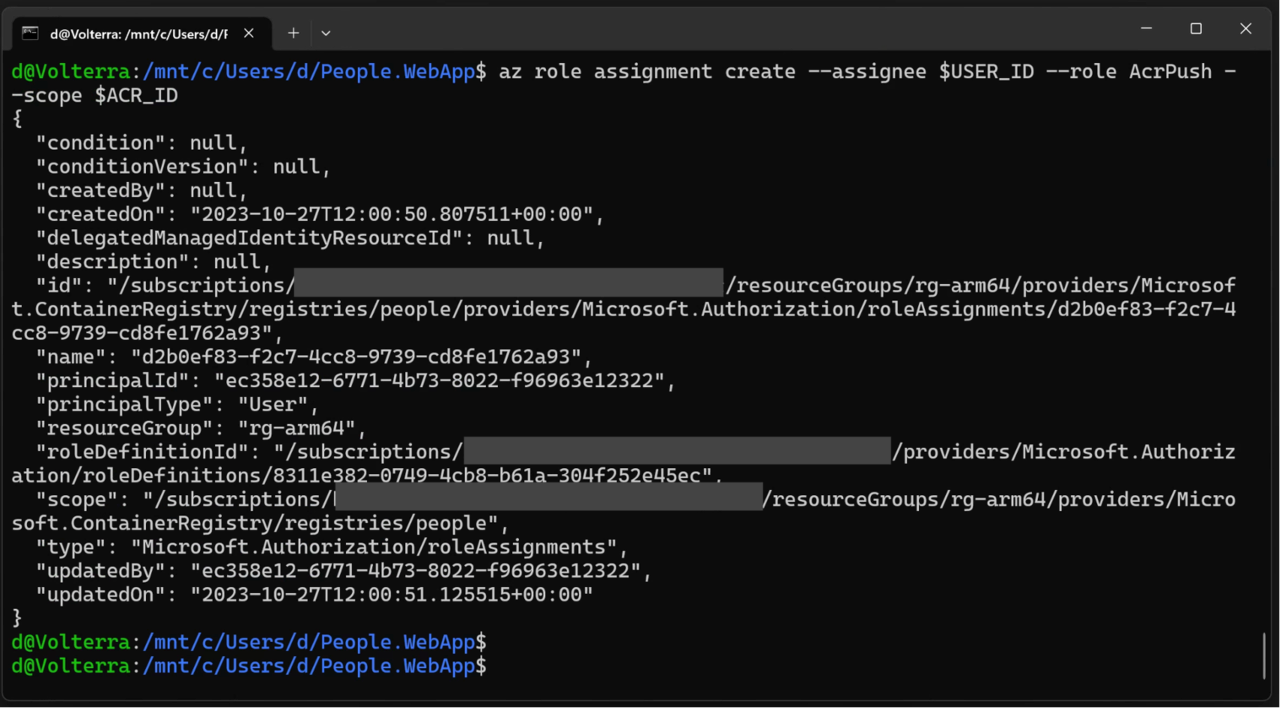

In the next step, we must configure the role assignment so that the current Azure user can push Docker images to the Azure Container Registry. To do so, we use the WSL terminal, in which we type:
USER_ID=$(az ad user show --id "<YOUR_USER_ID>" –query "id" -o tsv)
ACR_ID = $(az acr list --query "[?contains(name, 'people')].id" -o tsv)
az role assignment create --assignee $USER_ID --role AcrPush --scope $ACR_ID
Note You’ll need to replace <YOUR_USER_ID> with the username you used.
The last command’s output will look as follows: Image Alt Text:command prompt#leftFigure 21. Creating the role assignment
