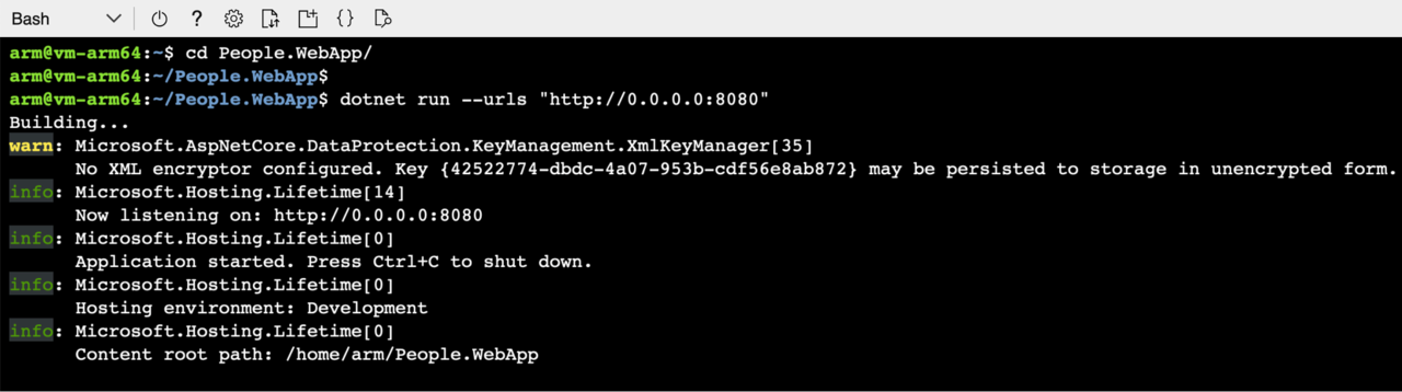

Then, run the application so that it will listen for requests on port 8080:
dotnet run --urls "http://0.0.0.0:8080"
After completing this step, you will see the following output:
Figure 14. Cloning and running the application

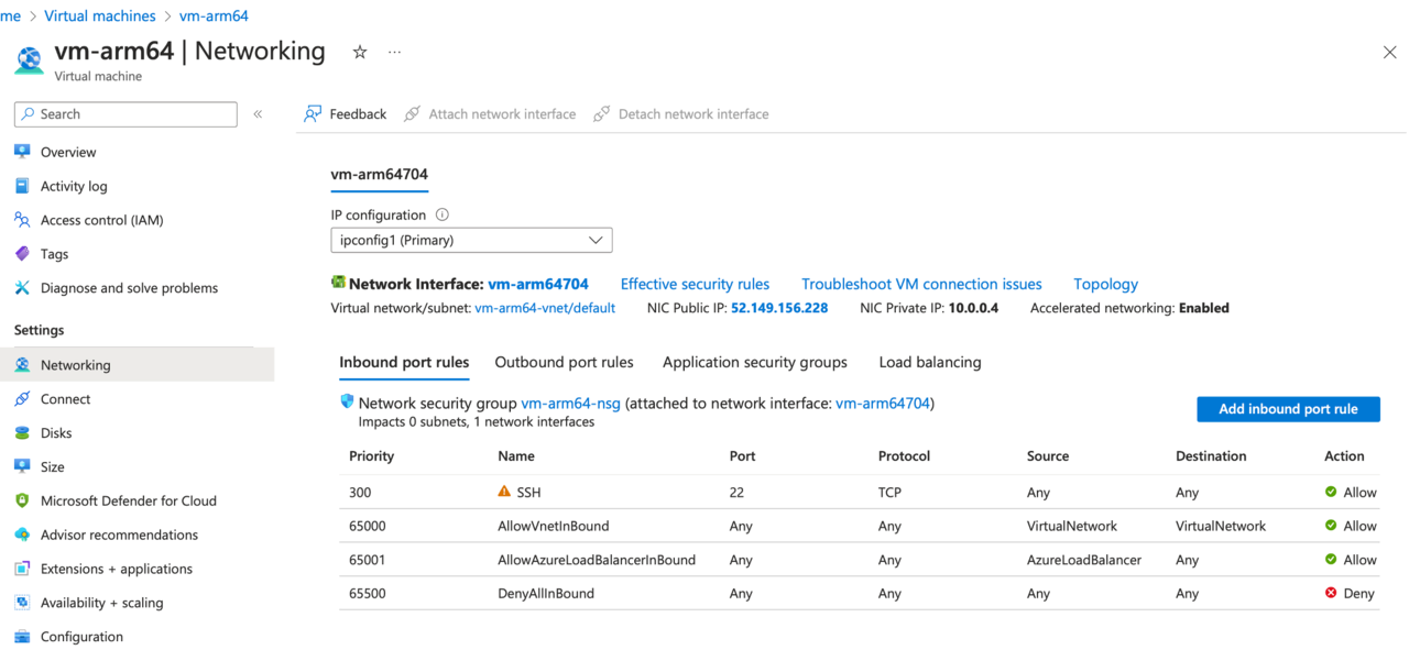

The application is ready and listening for the requests on port 8080. However, the network traffic is blocked on all ports except 22. You will need to configure the Network Security Group to enable the traffic.
To allow traffic on port 8080 for the Virtual Machine vm-arm64, proceed as follows:
Figure 15. Networking tab of the virtual machineIn the Networking tab of the Virtual Machine, click the Add inbound port rule button (it’s on the right). This will open a new popup window Add inbound security rule:
Figure 16. Adding inbound port rule
Ensure the rule is configured as follows:
Then, click Add and wait for the security rule to be applied.

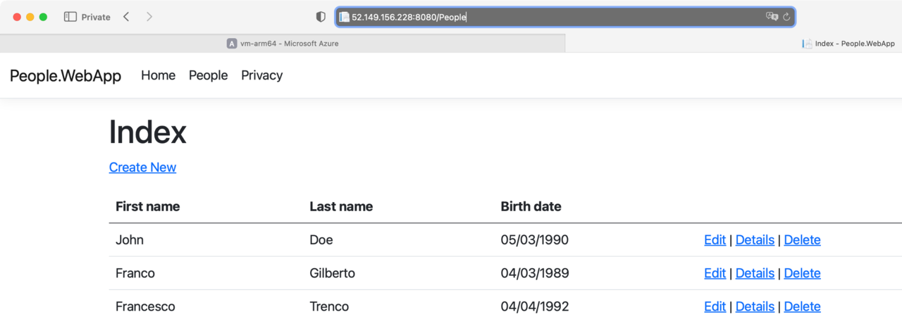

Once this is done, open your web browser and type the public IP address of your VM followed by 8080 port: 52.149.156.228:8080. You’ll see that the application is up and running:
Figure 17. An application deployed to Azure virtual machine
