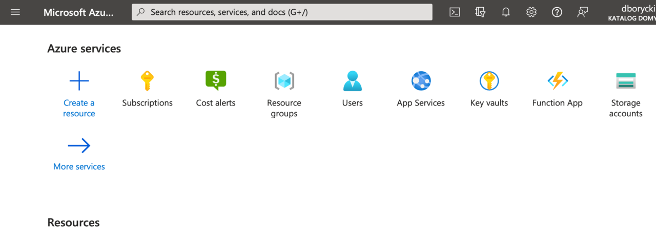

Let’s start by creating the Virtual Machine. Go to
https://portal.azure.com
and sign in. You will see this screen which enables you to create Azure resources:
Figure 1. A fragment of the Azure Portal

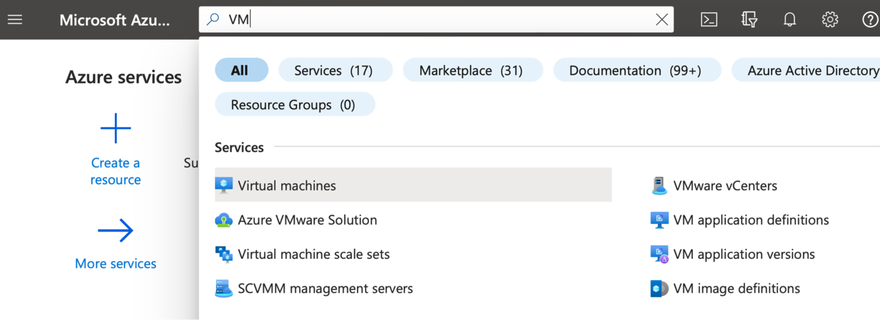

In the search box, type VM, and pick the first item on the list (Virtual machines):
Figure 2. Selecting the virtual machine Azure resource

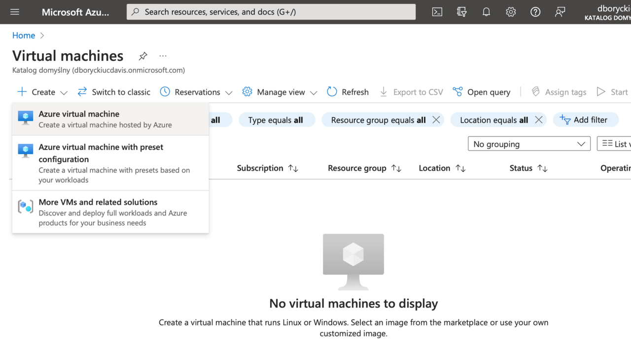

In the Virtual machines, click + Create (in the top left corner), and then select Azure virtual machine:
Figure 3. Creating the virtual machine

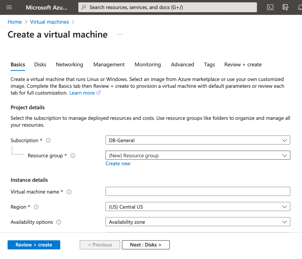

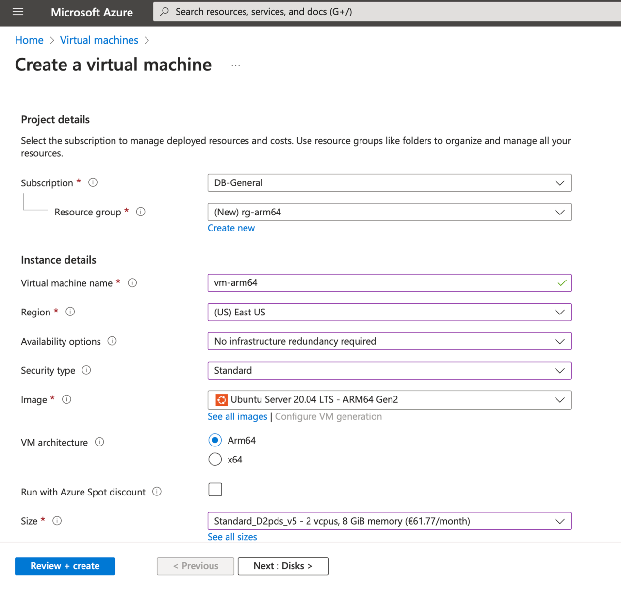

This takes you to the Create a Virtual Machine wizard as shown below:
Figure 4. Virtual machine wizard
Virtual machine configuration
Configure your VM with the following settings:
- Subscription: select your subscription
- Resource group: click Create new link, then type rg-arm64, and click OK
- Virtual machine name: vm-arm64
- Region: select depending on your physical location
- Availability options: select No infrastructure redundancy required
- Security type: Standard
- VM architecture: arm64
- Image: Ubuntu Server 20.04 LTS – ARM64 Gen 2
- Size:
- Click See all sizes
- In the Select a VM size, type D2pds in the search box
- Select D2pds_v5
This size might not be available due to quota limits. If this happens, click Request quota link (which is located next to the VM size name). This will activate a New Quota Request. Type 2 under New limit and click Submit. Wait a few minutes for the quota limits to be updated.At this point, your configuration should look like this example:
Figure 5. Virtual machine wizard (configured)

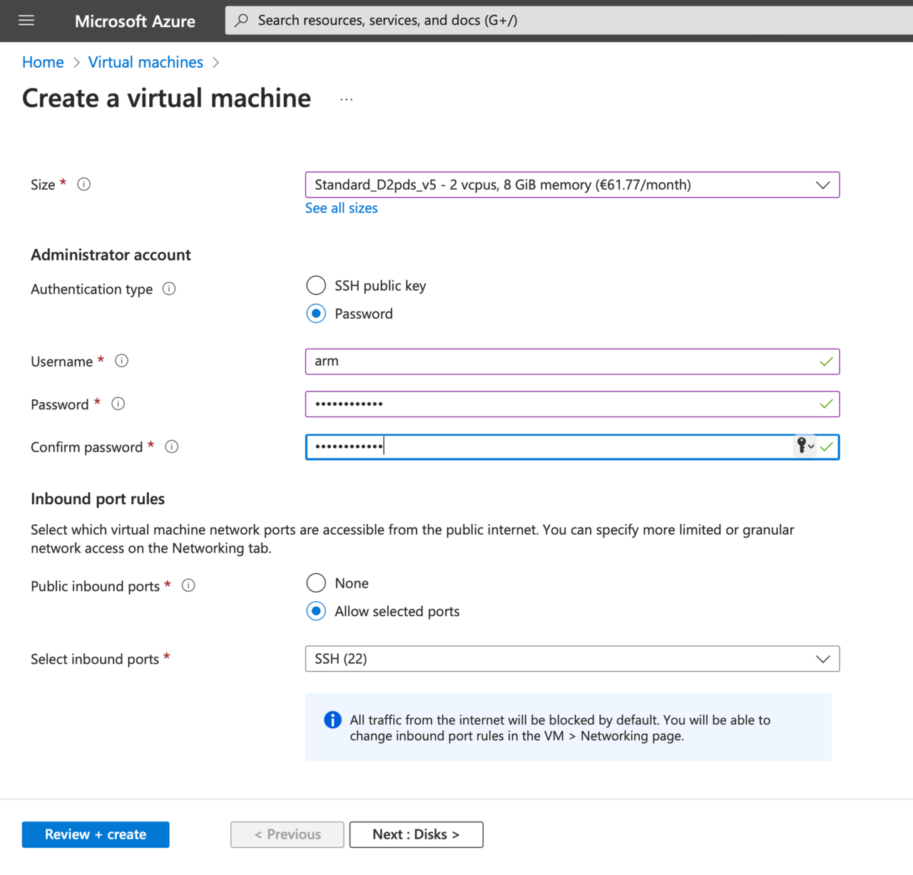

Let’s now configure other aspects of the Virtual Machine:
- Administrator account. Select Password, and then populate with:
- Username: arm
- Password: type your password (make a note of this password as you’ll need it to connect to VM)
- Confirm password: re-type your password
- Inbound port rules. Keep them default: SSH(22)
Figure 6. Administrator account and inbound rules of the virtual machine

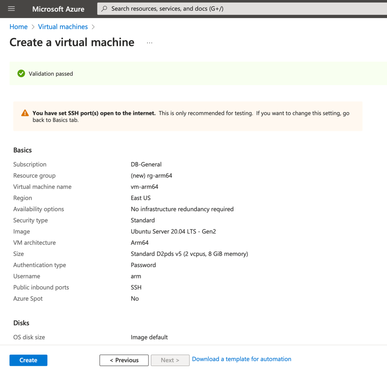

Click the Review + create button. The Azure Portal will validate your configuration and, if all is correct, you will see a green box saying: Validation passed:
Figure 7. A summary of the create virtual machine wizard

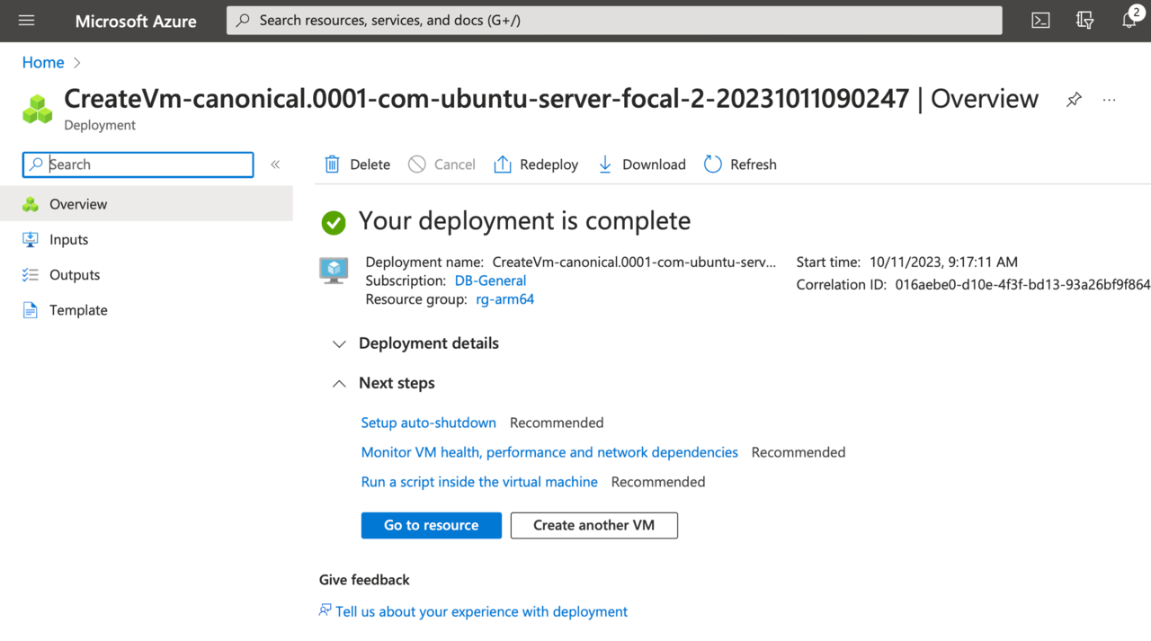

Wait a few moments for the deployment to be completed:
Figure 8. A confirmation screen

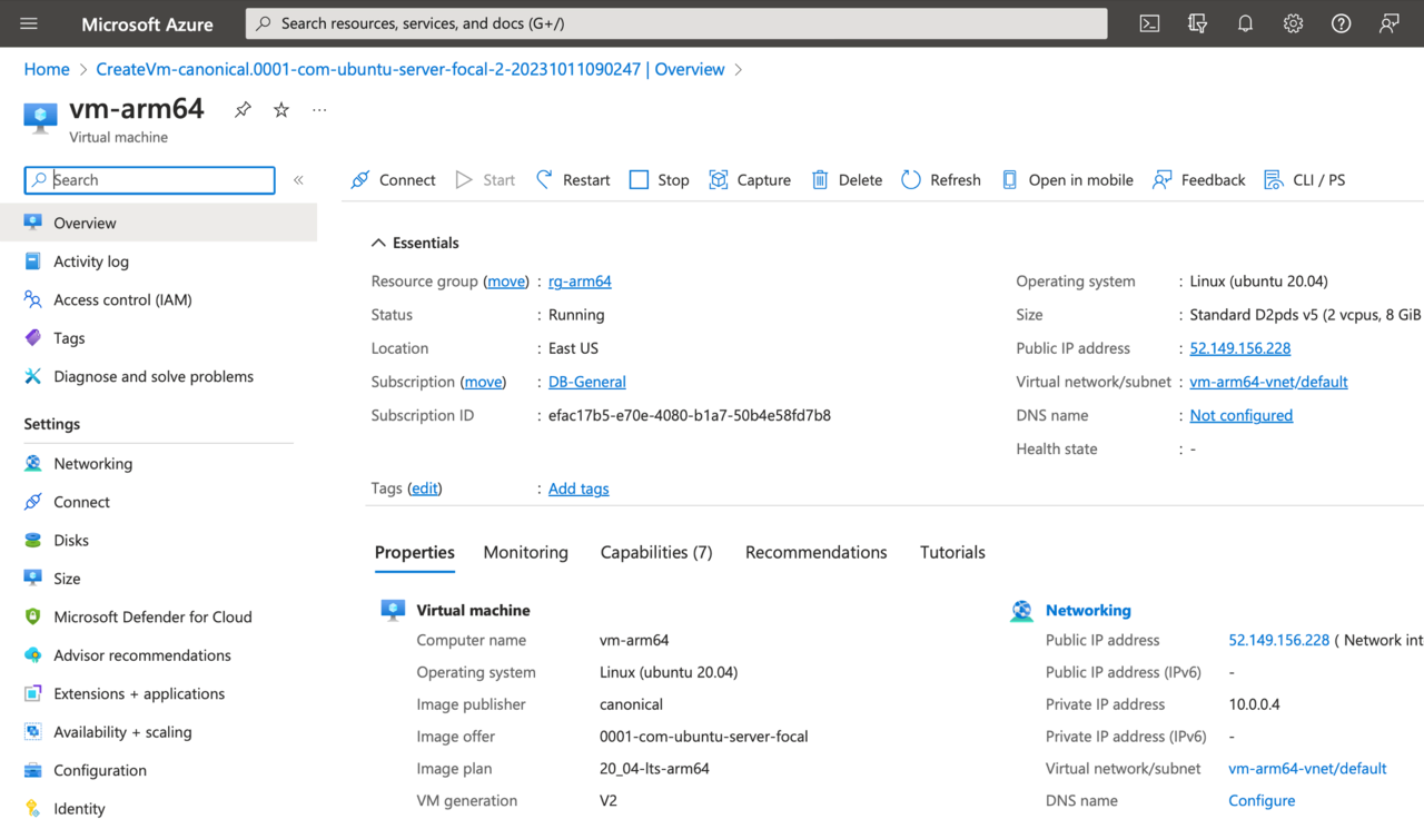

Finally, click the Go to resource button. You’ll be redirected to the overview of your newly created virtual machine in Microsoft Azure:
Figure 9. An overview of the virtual machine
Note your Public IP address (top right part of the overview). In this tutorial, this is 52.149.156.228.
