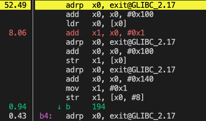

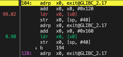

## Skid: When perf record misleads
The naive approach would be to record the events using the `perf record` subcommand. Running the following commands can be used to demonstrate skid, inaccuracy or “slippage” in the instruction location recorded by the Performance Monitoring Unit (PMU) when a performance event is sampled.
To record performance using PMU counters run:
```bash
sudo perf record -g ./false_sharing 1
sudo perf annotate
To record performance using Perf C2C and SPE run:
```bash
sudo perf c2c record -g ./false_sharing 1
sudo perf annotate
The left screenshot shows the canonical `perf record` command, here the `adrp` instruction falsely reports 52% of the time. However, using `perf c2c` that leverages `arm_spe`, you can see 99% of time associated with the `ldr`, load register command. The standard `perf record` data can be quite misleading!
### Using Perf C2C
Clearly Perf C2C is more accurate. You are able to observe the instruction that is being used most frequently. You can also find the specific variable causing the problem in the source code.
