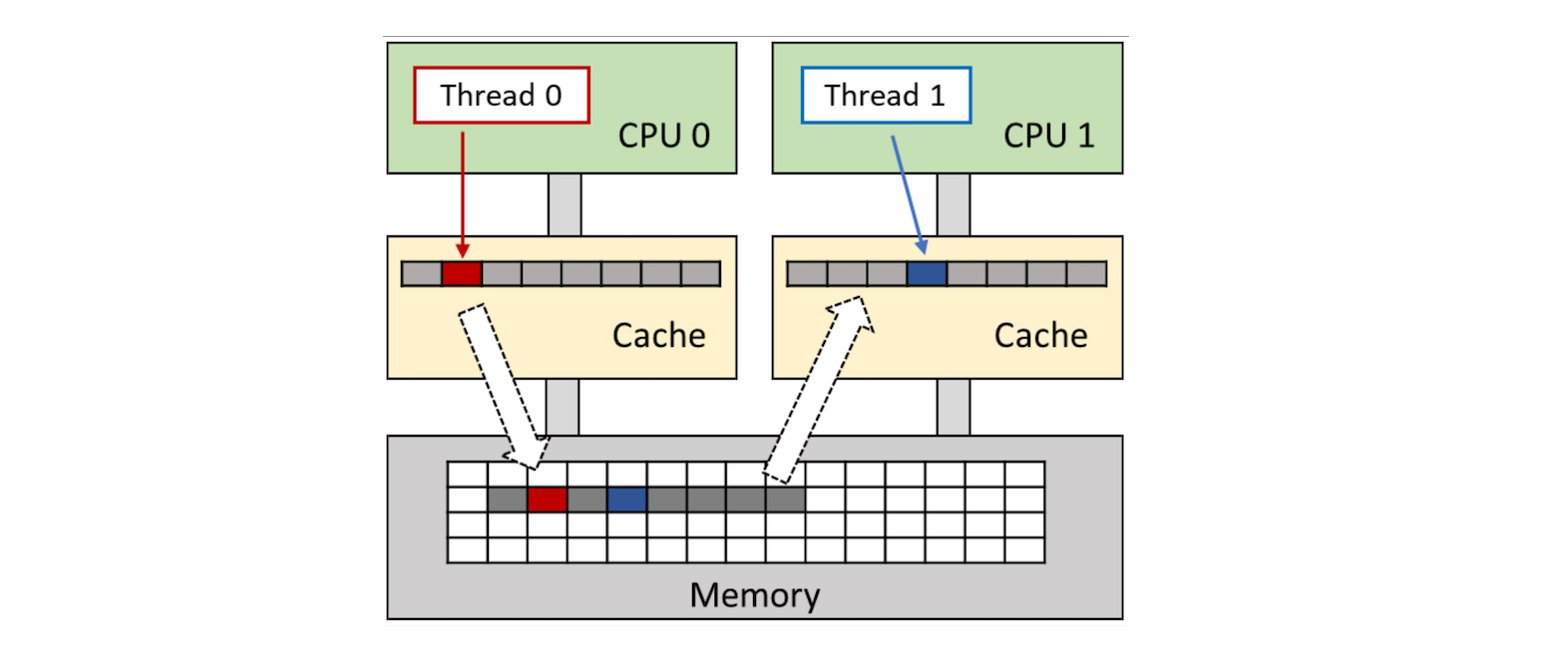

In large-scale, multithreaded applications, false sharing can degrade performance by introducing hundreds of unnecessary cache line invalidations per second - often with no visible red flags in the source code.
Even when two threads touch entirely separate variables, modern processors move data in fixed-size cache lines, which is typically 64 bytes. If those distinct variables happen to occupy bytes within the same line, every time one thread writes its variable the core’s cache must gain exclusive ownership of the whole line, forcing the other core’s copy to be invalidated.
The second thread, still working on its own variable, then triggers a coherence miss to fetch the line back, and the ping-pong pattern repeats.
The diagram below, taken from the Arm SPE white paper, provides a visual representation of two threads on separate cores alternately gaining exclusive access to the same cache line.
Two threads on separate cores alternately gain exclusive access to the same cache line.
