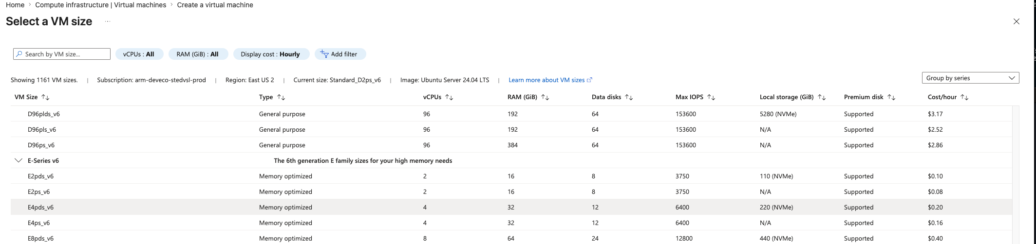

In Size, select See all sizes, choose the E-series v6 series, then select E4pds_v6.
Select the E-series v6 series and E4pds_v6Under Authentication type, choose SSH public key. Azure can generate a key pair and store it for future use. For SSH key type, ED25519 is recommended (RSA is also supported).

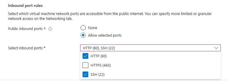

In Inbound port rules, select HTTP (80) and SSH (22).

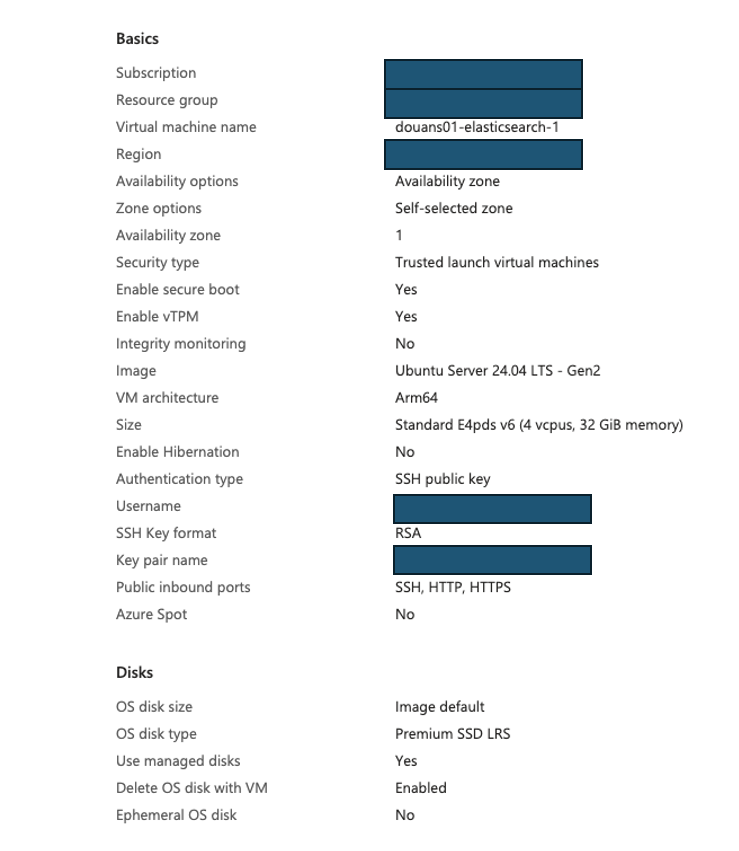

Allow inbound port rulesSelect Review + create and review your configuration. It should look similar to:

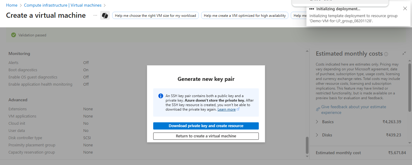

Review and create an Arm64 VM on Cobalt 100When you’re ready, select Create, then Download private key and create resources.

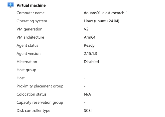

Download private key and create resourcesAfter deployment completes, confirm that the VM is running and note the public IP address.
VM deployment confirmation in the Azure portal
Your virtual machine should be ready in a few minutes. You can then connect over SSH using your private key and the VM public IP address.
