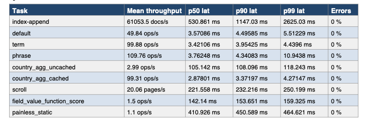

The following sample output shows a baseline geonames run on an Azure Cobalt 100 E4pds_v6 virtual machine. Your results will be similar but might vary slightly depending on VM load, Elasticsearch version, and available memory.
Indexing sustained a mean of about 61,054 docs/s with 0% errors. Common read-path workloads such as default search, term search, phrase search, and cached aggregation stayed in an excellent 3-4 ms p50 range.
The system completed the run without any old-generation garbage collections, suggesting healthy JVM behavior under this benchmark. The main latency costs appeared in heavier workloads such as uncached aggregation, scroll, expression queries, and script-based scoring. This is consistent with Elasticsearch performance expectations for compute-intensive query patterns.
### Example performance summary
![Performance summary for the E4pds_v6 Arm64 Cobalt 100 VM](https://learn.arm.com/learning-paths/servers-and-cloud-computing/elasticsearch-on-azure/images/performance-1.png)
*Performance summary for the E4pds_v6 Arm64 Cobalt 100 VM*

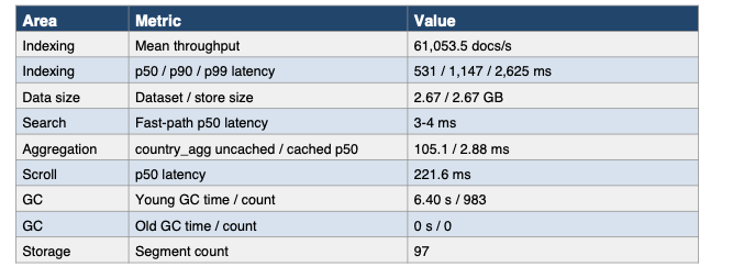

### Example detailed metrics
![Performance details on the E4pds_v6 Arm64 Cobalt 100 VM](https://learn.arm.com/learning-paths/servers-and-cloud-computing/elasticsearch-on-azure/images/performance-2.png)
*Performance details on the E4pds_v6 Arm64 Cobalt 100 VM*

- Indexing throughput averaged 61,054 docs/s (min 58,586 docs/s, max 64,191 docs/s) and completed with 0% errors.
- Common search workloads were consistently fast, with default, term, and phrase queries all clustered around 3-4 ms p50 latency.
- Caching made a major difference for aggregation: Cached country aggregation was about 36.5x faster than uncached at p50 latency (2.88 ms vs 105.1 ms).
- Scripted scoring remained expensive: `field_value_script_score` was about 1.39x slower than `field_value_function_score` at p50 latency (197.8 ms vs 142.1 ms). `painless_static` was the slowest task in the run at 410.9 ms p50, slightly ahead of `painless_dynamic` at 384.9 ms p50.
- Scroll and uncached aggregation were the most notable non-script latency costs at about 222 ms and 105 ms p50 latency, respectively.
- JVM behavior looked stable: 983 young-generation collections consumed 6.40 seconds total, and there were no old-generation collections.
- Merge work totaled 3.34 minutes with 1.25 minutes of throttle time, indicating some ingest-side background pressure but not a throughput collapse.
- The final store footprint matched the dataset size at 2.67 GB, suggesting low additional storage overhead in this run.
