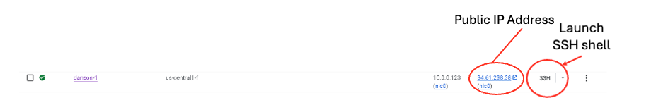

After the instance starts, select **SSH** next to the VM in the instance list to open a browser-based terminal session.
![Connecting to a running C4A VM using SSH](https://learn.arm.com/learning-paths/servers-and-cloud-computing/deepspeed-on-axion/images/gcp-pubip-ssh.png)
