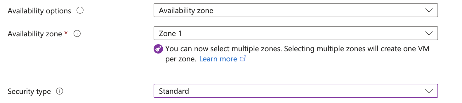

Availability options / Security type
These are reliability and security settings. They can generally be left as default.
Image Alt Text:az5 Select Availability options and Security type if necessary

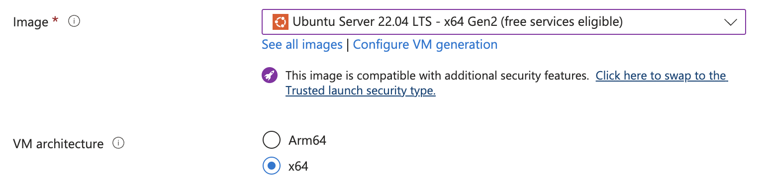

VM architecture
If not enabled automatically based on the above image, select Arm64 for an Arm-based operating system. This will update the Size pull-down (see below) to present Arm-based servers.
Image Alt Text:alt-text Choose the 'Arm64' VM architecture
