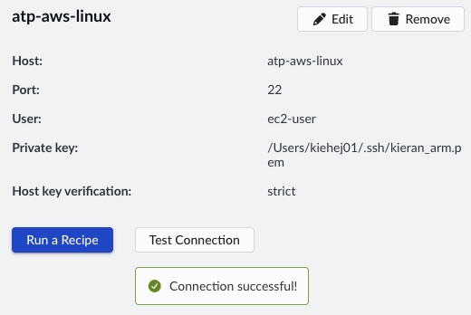

If this is your first time setting up Arm Performix, follow the Arm Performix install guide . In this Learning Path you’ll connect to an AWS Graviton3 metal instance (m7g.metal) with 64 Neoverse V1 cores, your remote target server. From the host machine, test the connection to the remote server by navigating to Targets > Test Connection. You should see the successful connection screen below.
Image Alt Text:The Arm Performix Targets panel showing a successful connection test result for a remote Arm serverSuccessful connection to remote target
