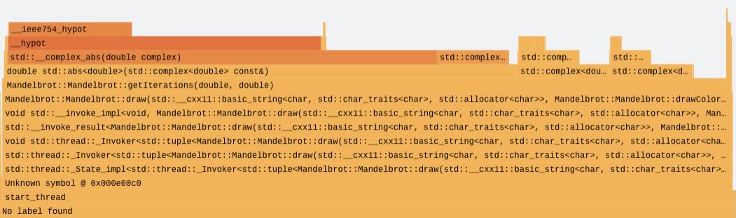

The flame graph below shows a typical profiling result.
Image Alt Text:A flame graph showing function call stacks with the x-axis representing relative sample frequency and the y-axis showing call stack depth. Wider blocks indicate functions that consumed more CPU time during profiling.Example flame graph
The x-axis represents the relative number of samples attributed to code paths, ordered alphabetically, not a timeline. A wider block means that function appeared in more samples and therefore consumed more CPU time. The y-axis represents call stack depth. Frames at the bottom are closer to the root of execution, such as a thread entry point, and frames above them are functions called by those below.
Each sample captures a snapshot of the current call stack. Many samples are then aggregated by grouping identical stacks and summing their counts, which is what makes flame graphs compact and readable. A common workflow is to start with the widest blocks, then move upward through the stack to understand which callees dominate that hot path. Reliable stack walking depends on frame pointers being present; they allow the profiler to unwind through nested calls and produce accurate stacks that merge cleanly into stable blocks.
