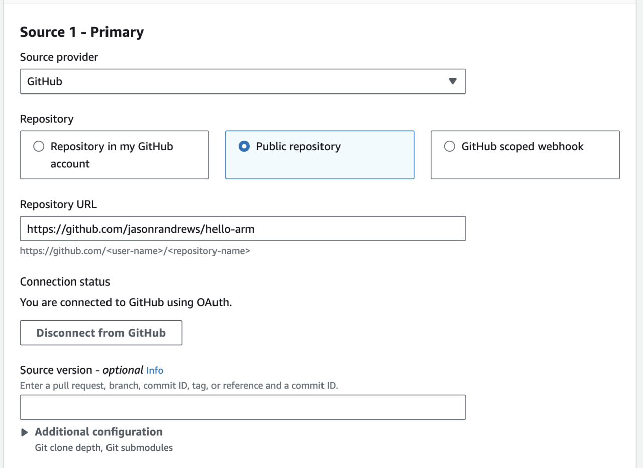

The Source section is where the GitHub project information is entered. To connect to GitHub use either OAuth or a personal access token. If OAuth is selected a dialog will open to login to GitHub and if a personal access token is selected it can be pasted into a box.
Image Alt Text: Source provider
After the GitHub connection is made enter the GitHub URL for the project. Enter the link to the hello-world project in GitHub.
