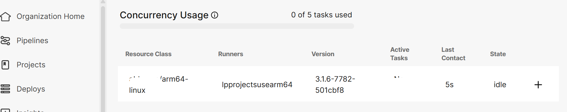

You can also confirm that your runner is connected and active by visiting the Self-Hosted Runners page in the CircleCI web dashboard.
Image Alt Text:CircleCI dashboard showing self-hosted runner status. The main panel displays a list of registered runners, including runner name, status indicator showing active, last seen timestamp, and resource class. The interface uses a clean layout with navigation on the left and a white background. The overall tone is professional and informative. alt-textSelf-Hosted Runners
