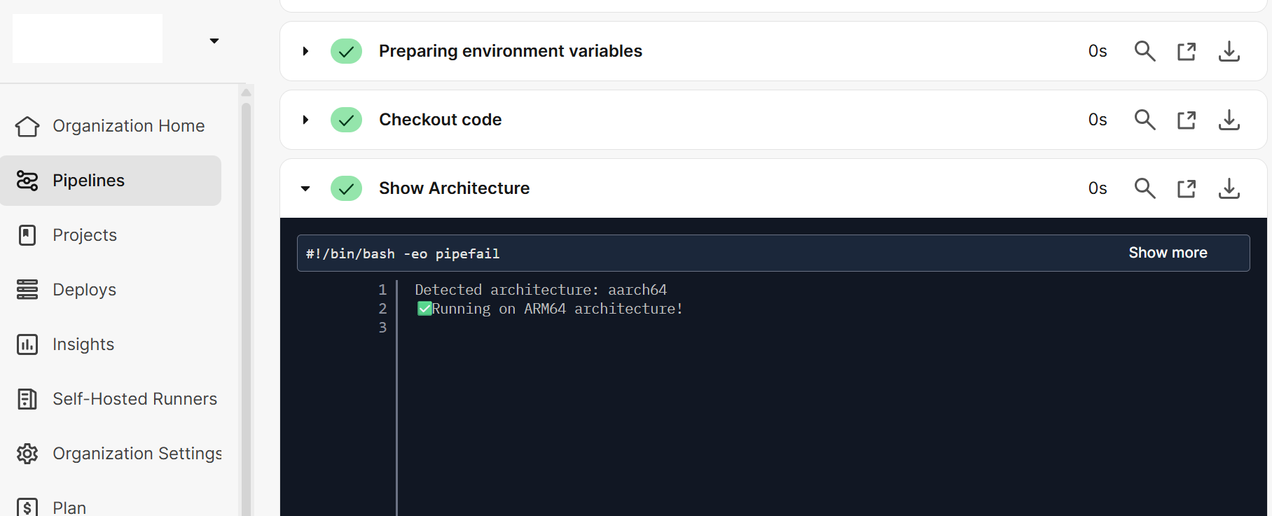

  1. Detect the ARM64 Architecture CircleCI confirms the job is executing on your Arm64 self-hosted runner. This validates that the pipeline is correctly targeting your Google Cloud C4A (Axion) VM.
Image Alt Text:CircleCI dashboard showing successful detection of ARM64 architecture. The main panel displays a terminal output with the message Detected architecture: aarch64 and a green checkmark indicating Running on ARM64 architecture. The interface includes navigation menus and job status indicators, conveying a positive and successful workflow execution environment. alt-textShow architecture

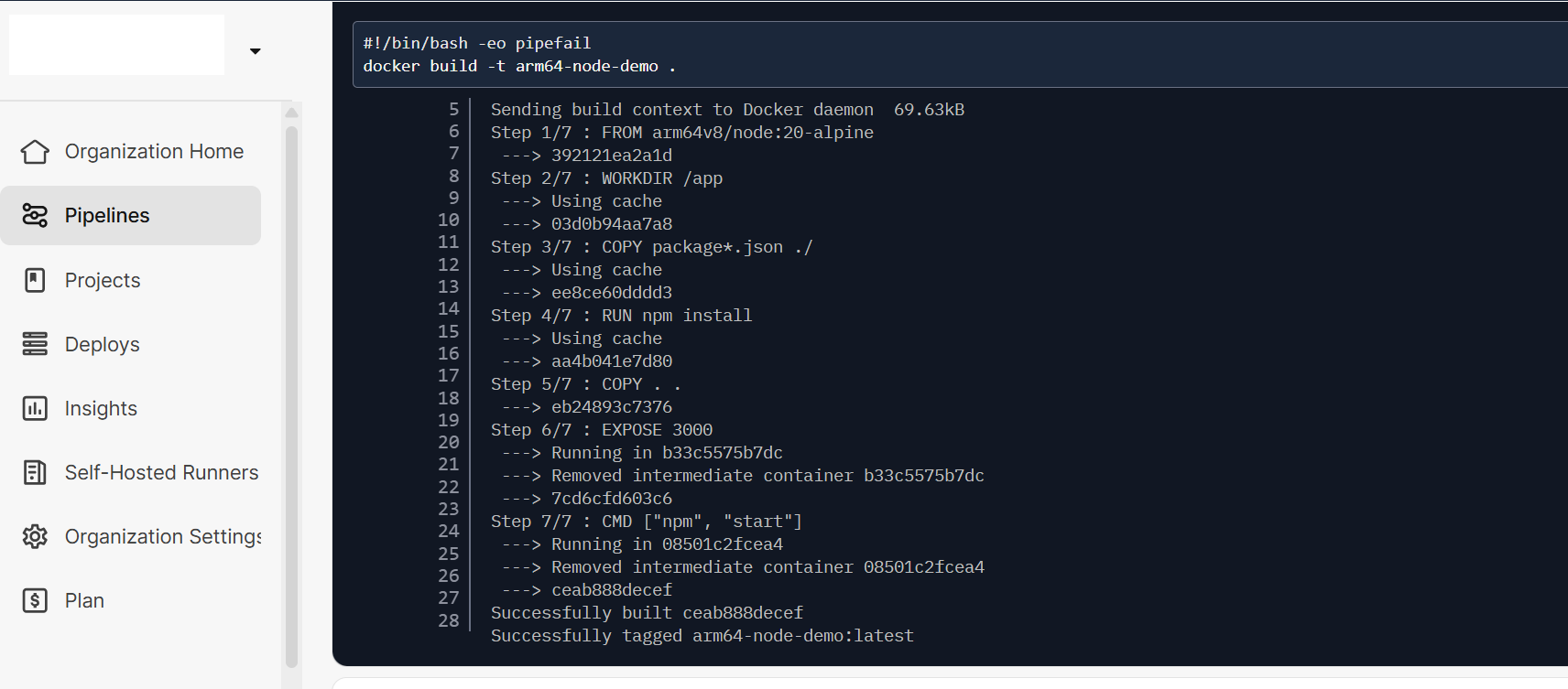

Build the Docker image
The runner builds the arm64-node-demo Docker image using the Dockerfile you defined.
Image Alt Text:CircleCI dashboard displaying the Docker image build stage. The main panel shows terminal output with the command docker build -t arm64-node-demo and progress logs indicating successful build steps. The interface includes navigation menus, job status indicators, and a green checkmark signaling a successful build. The environment appears organized and professional, conveying a sense of accomplishment and progress in the workflow. alt-textDocker Image

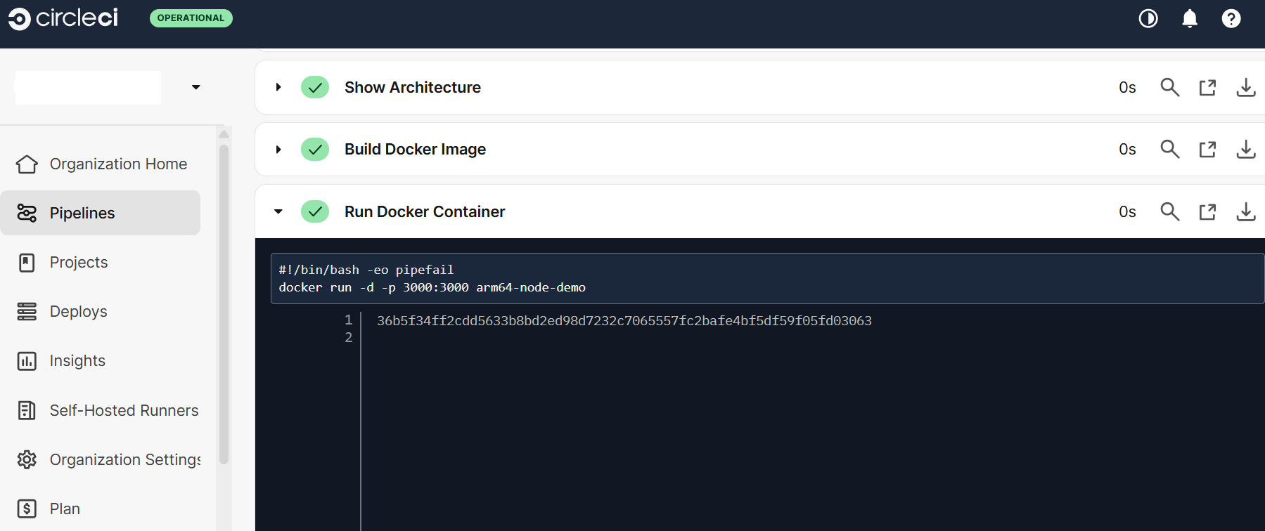

Run a container from the image
Once the image is built, the job launches a container to host your Node.js web app.
Image Alt Text:CircleCI dashboard showing the container run stage. The main panel displays terminal output with the command docker run -d -p 3000:3000 arm64-node-demo and status messages confirming the container is running. The interface includes navigation menus, job status indicators, and a green checkmark indicating successful execution. The environment appears organized and professional, conveying a sense of progress and accomplishment. alt-textContainer Run

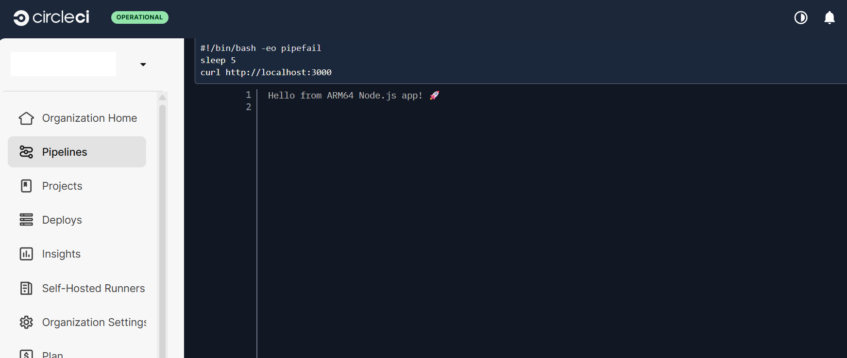

Test the application by hitting the end point
The workflow tests the running app by sending an HTTP request to http://localhost:3000. Image Alt Text:CircleCI dashboard displaying the application endpoint test stage. The main panel shows terminal output with the command curl http://localhost:3000 and the response Hello from ARM64 Node.js app followed by a rocket emoji. The interface includes navigation menus, job status indicators, and a green checkmark indicating successful execution. The environment feels positive and organized, highlighting a successful application test within the workflow. alt-textVerify App
If the app responds with the expected message, you know your Node.js web server is running correctly inside the container.
