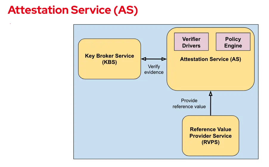

Attestation Service (AS)
The Attestation Service (AS) validates TEE evidence. In RATS terms, the AS is the Verifier. The AS receives attestation evidence and returns an attestation token containing the results of a two-step verification process.
The following diagram shows the AS components:
Image Alt Text:Attestation Service components alt-textAttestation Service components
The AS performs this verification flow:
  • Verify format and origin of evidence – for example, verify the evidence signature. This is handled by a platform-specific Verifier driver.
  • Evaluate claims – for example, validate that measurements match expected values. This is handled by the Policy engine, with RVPS support.

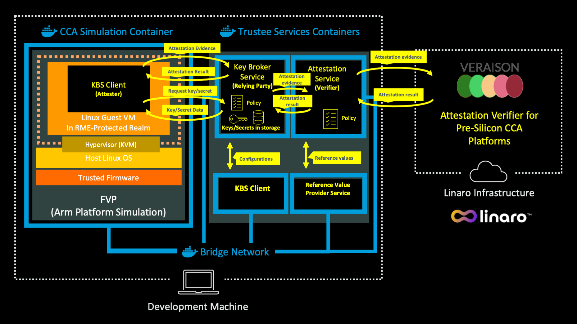

For convenience, Trustee services and the client software are packaged in Docker containers, which you can run on any suitable AArch64 or x86_64 development host. Because the client runs in a realm, it uses the Fixed Virtual Platform (FVP) and the reference software stack for Arm CCA. If you are new to running applications in realms with FVP, see Run an application in a Realm using the Arm Confidential Computing Architecture (CCA) .
When the AS receives an attestation token from the realm using the KBS, it:
  • Calls an external CCA Verifier (the Linaro attestation Verifier service) to obtain an attestation result.
  • Checks the token’s cryptographic signature and confirms that it represents a confidential computing platform.
  • Evaluates evidence in the token against its policies and updates the attestation result and trustworthiness vectors.
When a resource is requested, the KBS uses the attestation result to decide whether to release secrets to the realm for processing.
This diagram shows the software architecture you will construct to run the attestation example:
Image Alt Text:Software architecture for running attestation alt-textSoftware architecture for running attestation
Proceed to the next section to run the end-to-end attestation example using the components and architecture described here.
