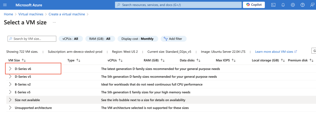

In the Size field, click on See all sizes and select the D-Series v6 family of VMs. Select D2psv6 from the list and create the VM.

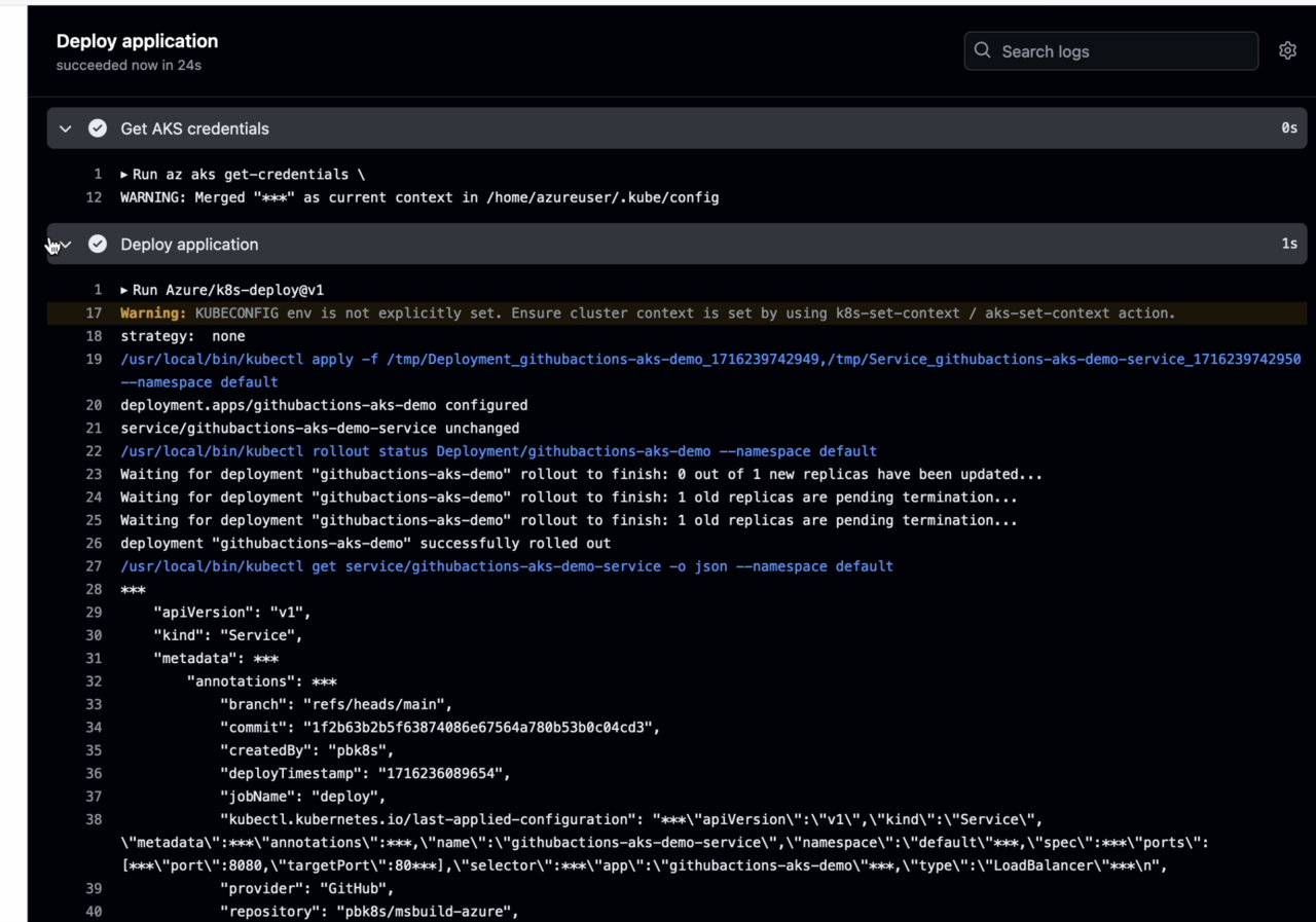

How do I run the CI/CD pipeline?
The next step is to trigger the pipeline manually by navigating to Actions tab in the GitHub repository. Select Deploy .NET app, and click on Run Workflow. You can also execute the pipeline by making a commit to the repository. Once the pipeline executes successfully, you will see the Actions output in a format similar to what is shown below:

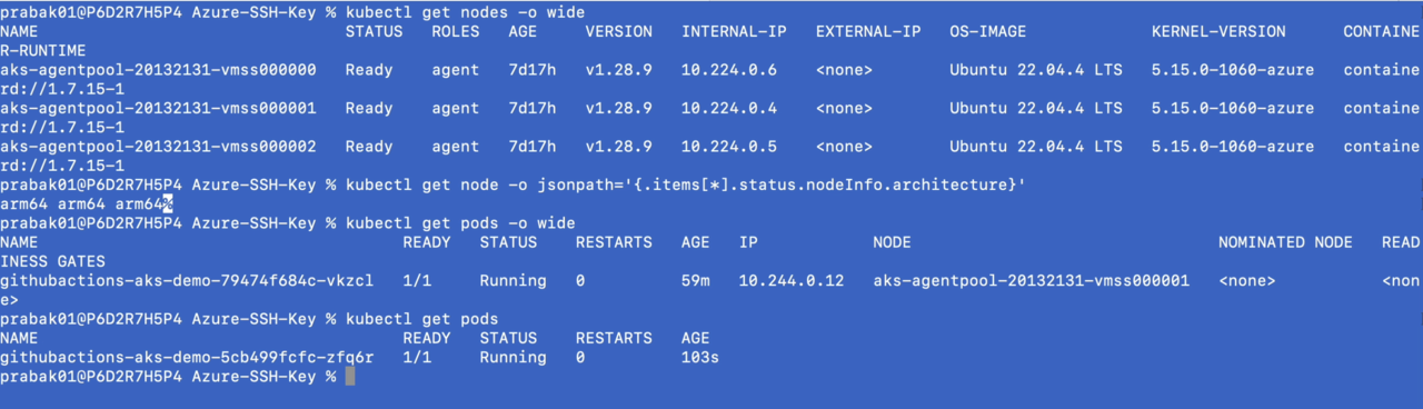

You can check your kubernetes cluster and see new application pods deployed on the cluster as shown below:
Image Alt Text:kubernetes-deployment
