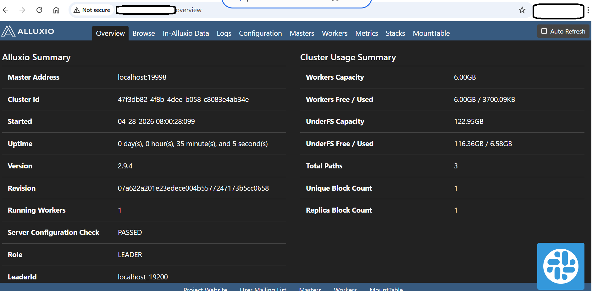

Open the Alluxio Web UI in your browser. Replace <VM-IP> with the public IP of your VM:
http://<VM-IP>:19999
Alluxio Web UI with cluster summary and worker details
In the Alluxio Web UI, you can see the master status for the leader node, worker memory usage, storage capacity, cached data blocks, and overall cluster health.
You now have Alluxio running on your Azure Cobalt 100 virtual machine with a memory-backed cache layer configured and all services reporting healthy. The Web UI at port 19999 gives you visibility into worker status, storage capacity, and cached data blocks.
