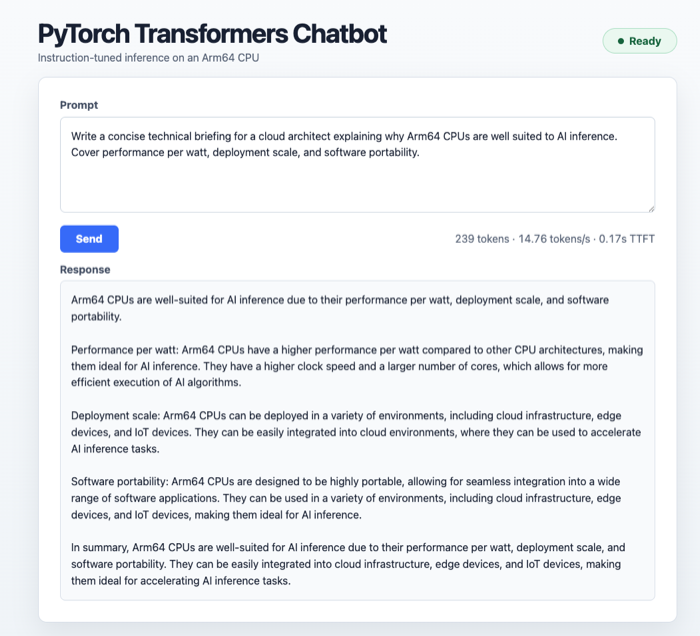

This workflow has been successfully tested for generating an adapter to support PyTorch Transformers models.
Image Alt Text:PyTorch Transformers chatbot running an instruction-tuned model through a generated adapter on an Arm64 CPU. The interface reports a ready state and displays streamed text with token throughput and time-to-first-token metrics.Generated adapter running a PyTorch Transformers text-to-text model

This validation checks the adapter structure and required package files. It doesn’t load the model or confirm that native operators, prompt formatting, and generated text are correct. You’ll confirm runtime compatibility when you run a representative prompt on the target machine.
