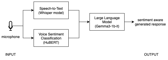

End-to-end response time may take a few seconds because the application runs Whisper transcription, ONNX sentiment inference, and local LLM generation for each interaction.
Image Alt Text:Integrated pipeline diagram showing audio input splitting into two parallel paths: Whisper produces transcript text and HuBERT produces sentiment label, both feeding into an LLM prompt that generates context-aware responsesIntegrated voice-to-LLM pipeline
