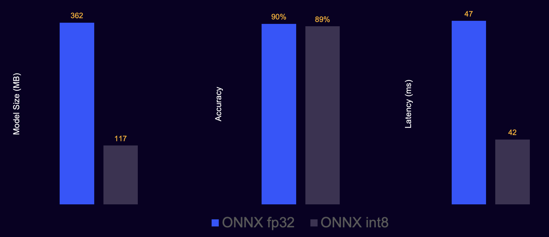

## Model compression results
You can also compare the model metrics before and after quantization.
![Model ONNX conversion and int-8 quantization results](https://learn.arm.com/learning-paths/mobile-graphics-and-gaming/voice-sentiment-analysis-with-llm/4_modelconversionandcompression.png "Model ONNX conversion and int-8 quantization results")
Typical results look like:
Original ONNX model: larger size, higher memory footprint
Quantized INT8 ONNX model: smaller size, lower memory footprint, faster CPU inference
