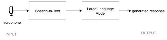

In this section, you’ll build an end-to-end pipeline that:
- Records audio from your microphone
- Transcribes it to text using Whisper
- Sends the text to a locally hosted LLM
- Displays the model’s response
This forms the foundation of your voice assistant.
![Baseline voice-to-LLM pipeline](https://learn.arm.com/learning-paths/mobile-graphics-and-gaming/voice-sentiment-analysis-with-llm/3_vsapipeline1.png)
*Baseline voice-to-LLM pipeline*
Before you begin, make sure you have completed the environment setup in the previous section and that your `llama-server` is still running.
