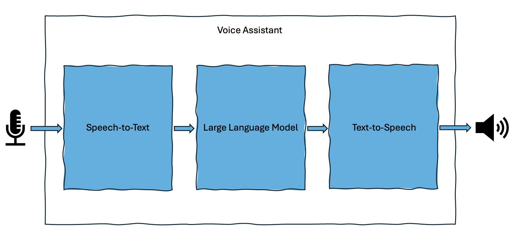

Voice Assistant application workflow
The Voice Assistant application implements a full voice interaction pipeline on Android, enabling real-time, conversational interactions.
Image Alt Text:example image alt-textThe voice interaction pipeline.
It generates intelligent responses using:
  1. Speech-to-Text (STT) to transform the user’s audio input into text.
  2. A Large Language Model (LLM) to generate a response in text form.
  3. Android Text-to-Speech (TTS) API to produce a spoken reply.
The following sections describe how each component works in the application.
