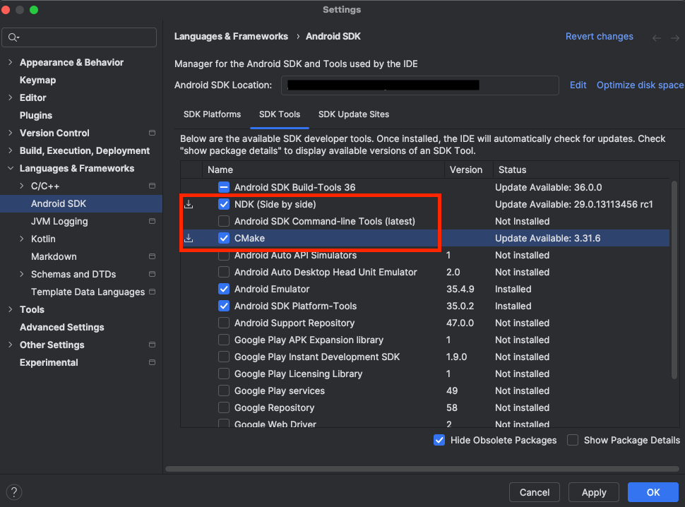

You can use Android Studio to obtain the NDK.
Click **Tools > SDK Manager** and navigate to the **SDK Tools** tab.
Select the **NDK (Side by side)** and **CMake** checkboxes, as shown below:
![Image Alt Text:Install NDK](https://learn.arm.com/learning-paths/mobile-graphics-and-gaming/vision-llm-inference-on-android-with-kleidiai-and-mnn/install_ndk.png)
See [Install NDK and CMake](https://developer.android.com/studio/projects/install-ndk) for other installation methods.
