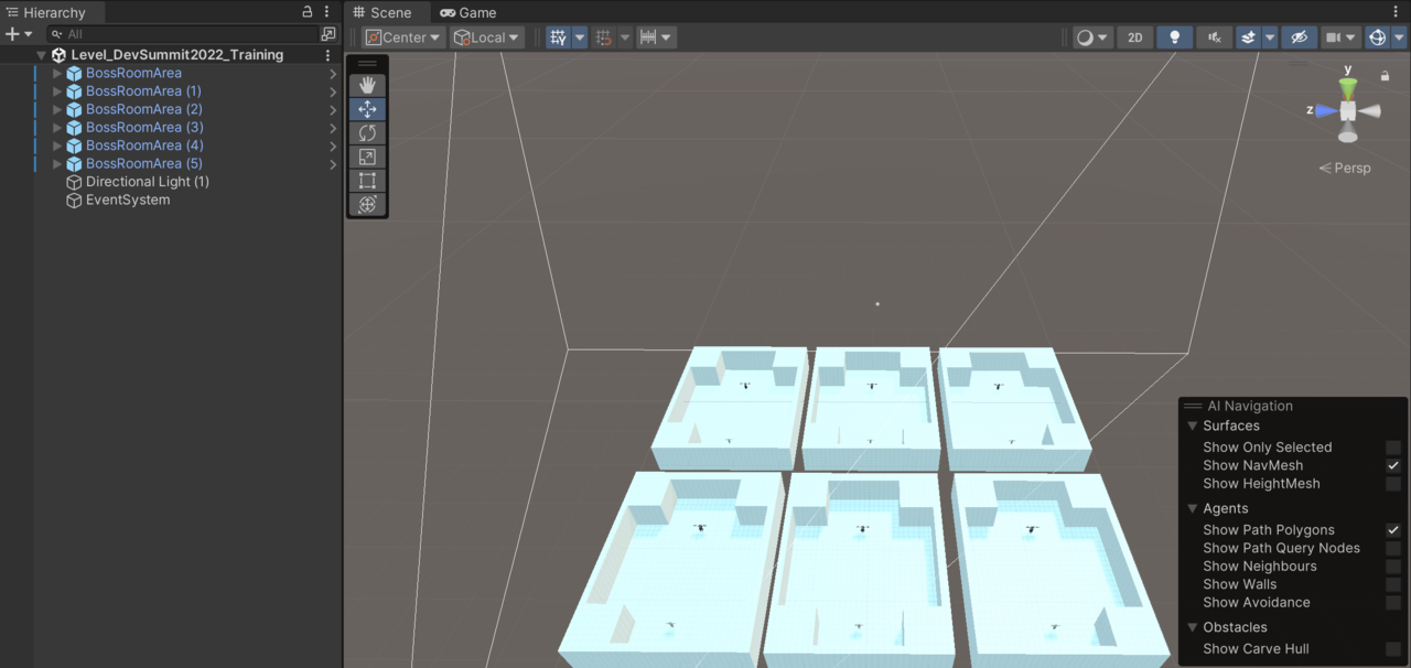

![Image Alt Text:Training Scene](https://learn.arm.com/learning-paths/mobile-graphics-and-gaming/using_unity_machine_learning_agents/images/training-scene.webp)
*Figure 1. The Training Scene (again)*
### Multiple simultaneous battles
Six “arenas” are employed in the training scene (you may have to adjust your view in Unity to be able to see all of them). Running multiple battles simultaneously speeds up the training. If you have more CPU power, you could use more.
