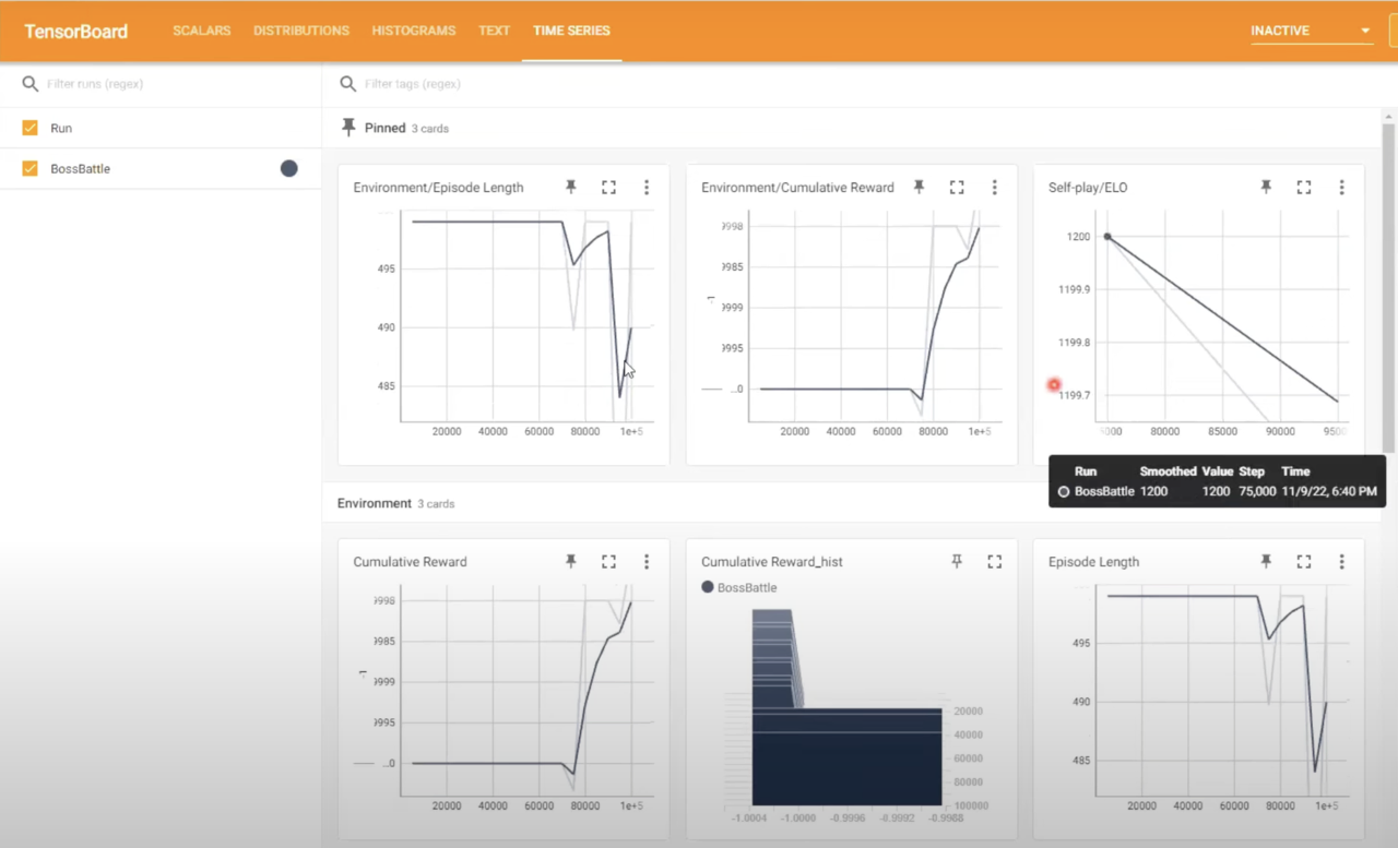

5. Now open up your browser to http://localhost:6006 (the port that was passed to the launch command), which should look similar to this:
![TensorBoard UI](https://learn.arm.com/learning-paths/mobile-graphics-and-gaming/using_unity_machine_learning_agents/images/tensorboard-ui.webp)
*Figure 7. TensorBoard UI*
6. Some cards to take a note of:
   - *Episode Length*: Initially when no one is winning the episode length is maximum steps, until someone wins. Then the average slowly comes down. Once they start winning regularly it should come down a lot.
   - *Cumulative Reward*: Starts off being -1, because both sides is losing, but once they start regularly having a winner it will go up rapidly and will eventually settle around zero, as each (evenly-matched) player will lose as often as they win.
   - *ELO*: As mentioned previously this is the score over time, as characters win, giving you an idea of how well your training is going.
