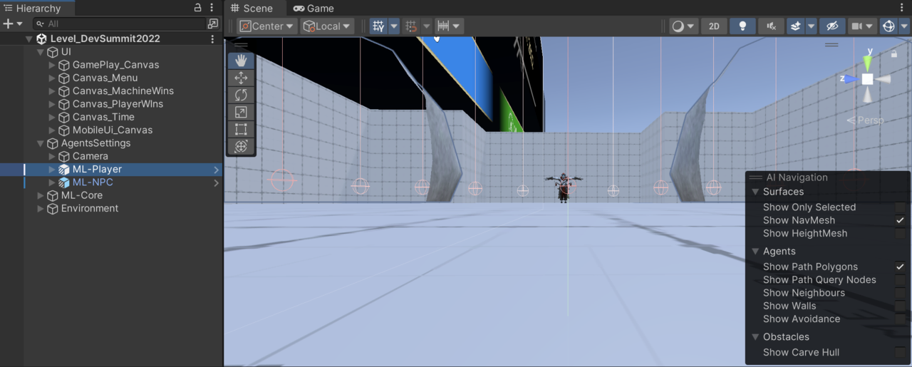

  5. To get a better look at the scene from the player’s perspective, right click on ML-Player and select Align View to Selected. This will change the scene view to the viewpoint of your player character at ground level. You will see the inside of the arena and the enemy character in the distance.
    Image Alt Text:Align View to ML-PlayerFigure 2. Align View to ML-Player

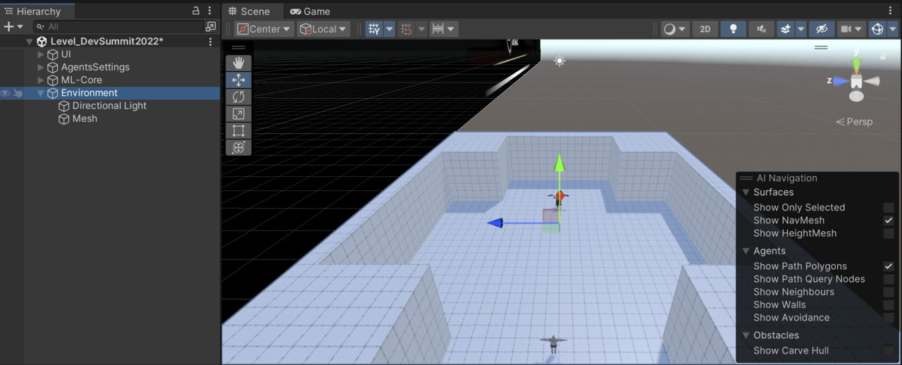

Environment
The entire scene is lit from a single light called “Directional Light”. The light is marked as “Realtime” so it doesn’t include any baked lighting.
Image Alt Text:EnvironmentFigure 12. Our world consists of a single light and a single mesh for the whole battle arena.
(You could add baked lighting or more realtime lights to make the lighting more interesting, but this is outside the scope of this learning path. If you do experiment with the lighting, remember that adding extra lights and changing some options can affect performance.)
