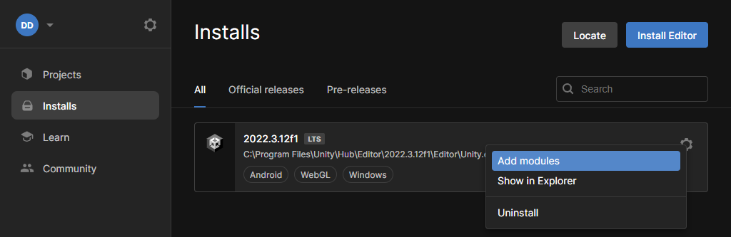

3. Add Android Build support
   1. Click the *Settings* icon and choose *Add Modules*
      ![Image Alt Text:Unity Hub Installs](https://learn.arm.com/learning-paths/mobile-graphics-and-gaming/using_unity_machine_learning_agents/images/unityhubinstalls.png)
      *Figure 1. List of Unity versions installed*
