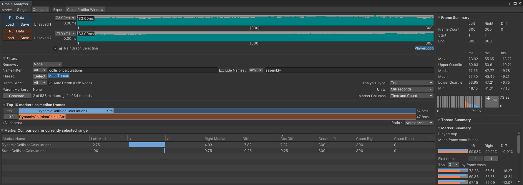

You now have two datasets loaded, one from the unoptimized mode and one from the Burst mode. This is what the data looks like collected from our sample device.
Focus on the collision-related markers by searching for collisioncalc in the Name Filter. Select a representative frame by clicking on a later frame where both seem relatively settled (and with no odd spikes).
We will ignore CollisionMovement because it has not been optimized and the times will vary depending on exactly how many collisions are occurring in any one frame.
The functions that have been optimized are the collision detection calculations. All characters are compared against all characters and walls. The character-wall collision detection times are collected under the sample name StaticCollisionCalculations while the character-character collisions are collected under the name DynamicCollisionCalculations.
In the top 10 markers, the unoptimized data is in blue. The Burst data is in orange. StaticCollisionCalculations is showing the biggest improvement. The data shown above is based on all frames selected. You can see individual frames if you click on the graph.

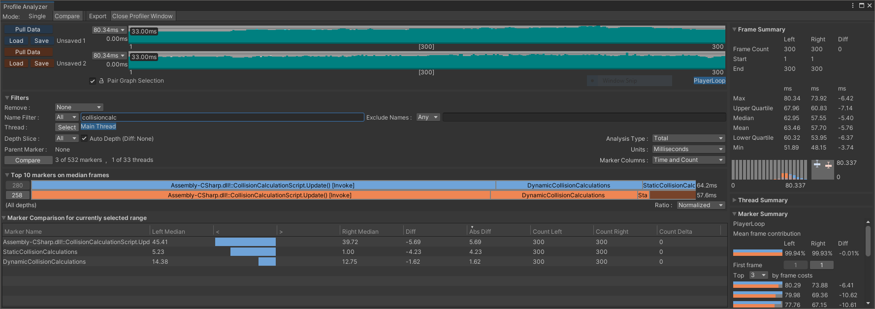

Follow the same process again but this time we will compare Burst against Neon.
Again, we can see an improvement, mostly with the dynamic (character-character) collision detection but together it still makes a meaningful improvement.
