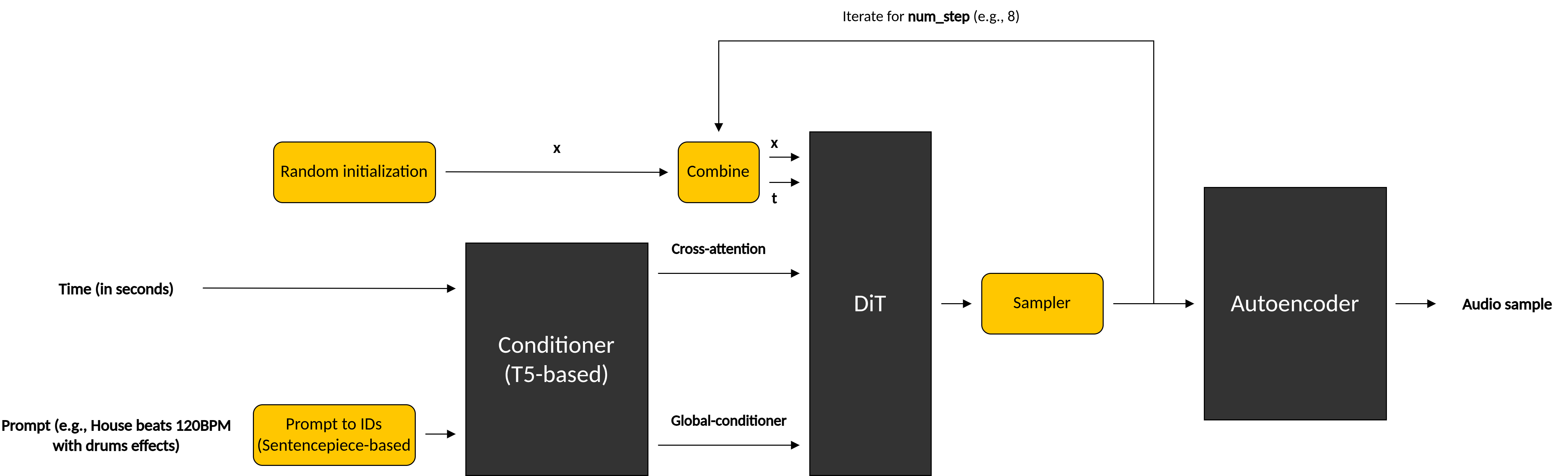

The open-source model consists of three main submodules. They are described in the table below, and come together through the pipeline shown in the image.
| Submodule                 | Description                                                                                                                                                       |
| Conditioners              | Includes a T5-based text encoder for the input prompt and a numerical duration encoder. These components convert the inputs into embeddings passed to the DiT model. |
| Diffusion Transformer (DiT)| Denoises random noise over multiple steps to produce structured latent audio, guided by conditioner embeddings.                                                  |
| AutoEncoder               | Compresses audio waveforms into a latent representation for processing by the DiT model, and decompresses the output back into audio.                           |
