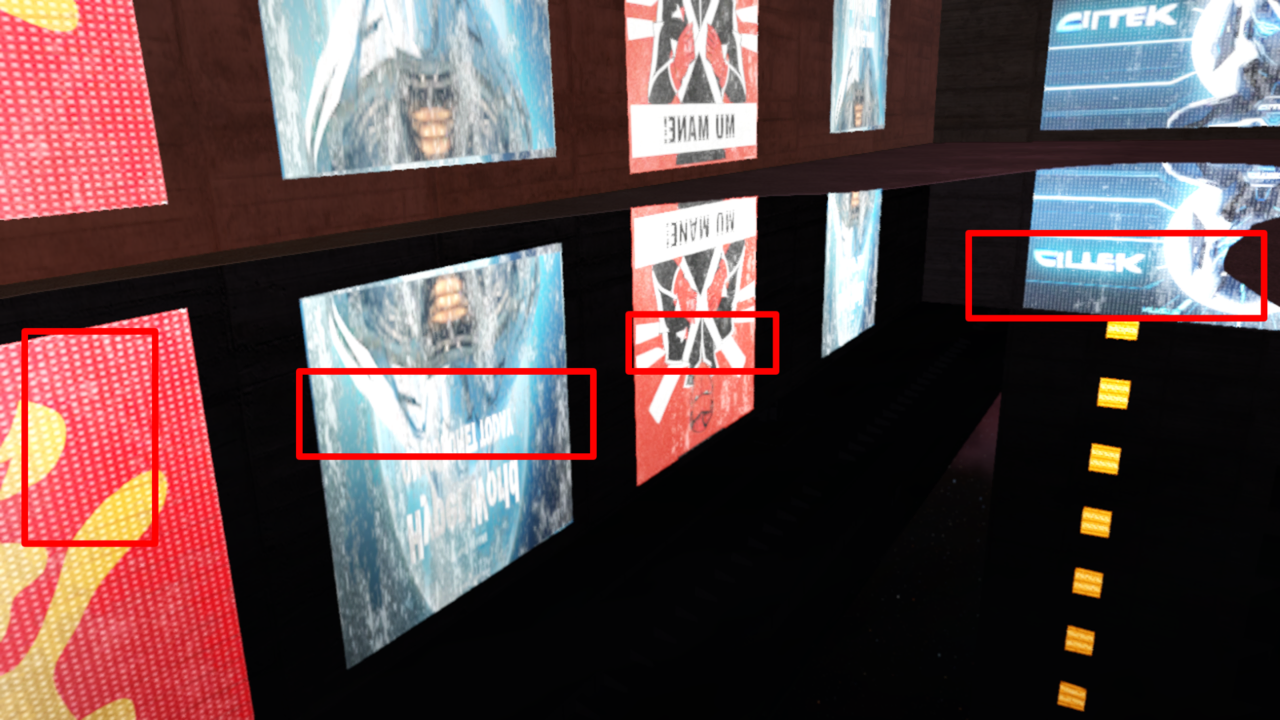

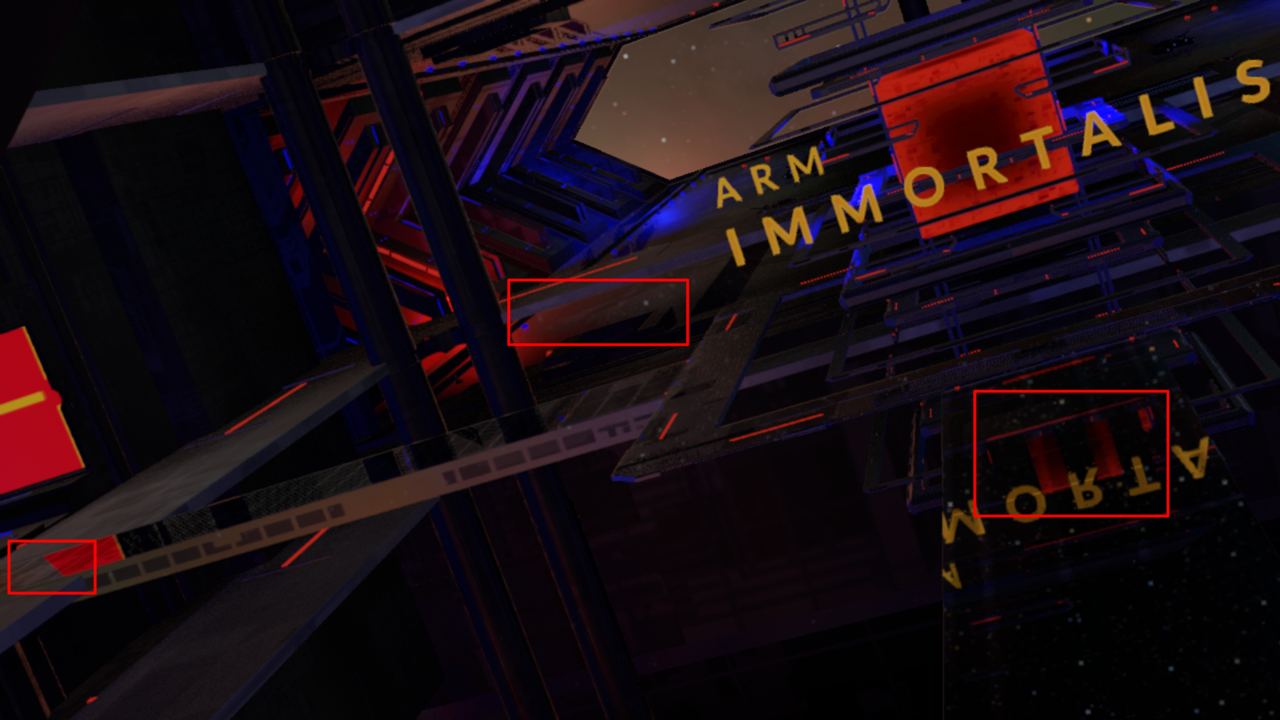

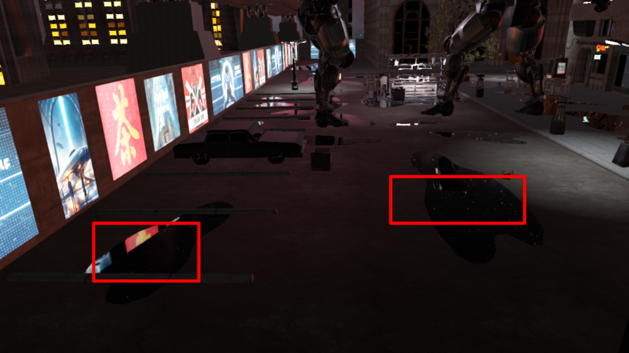

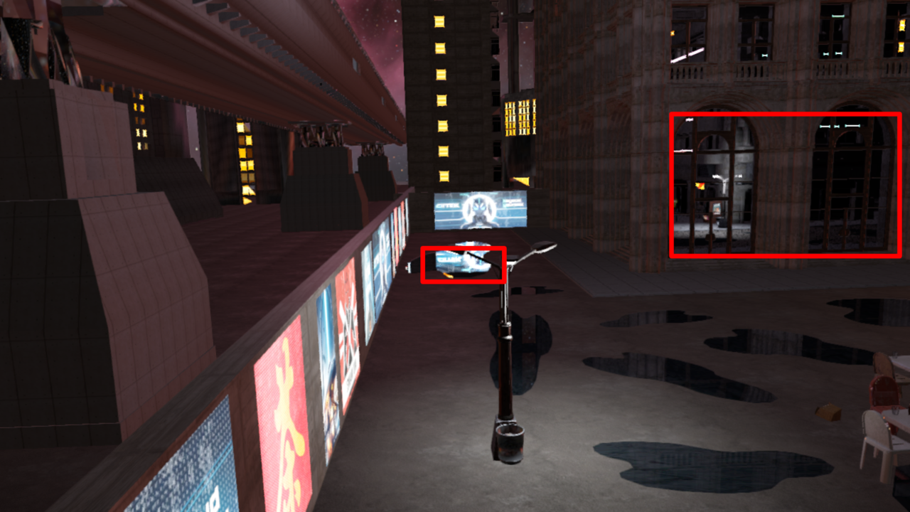

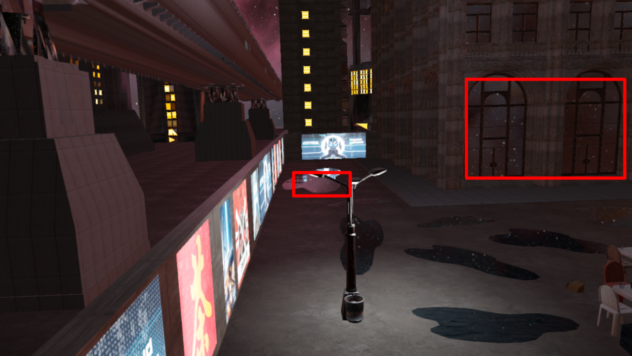

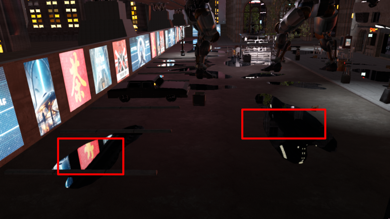

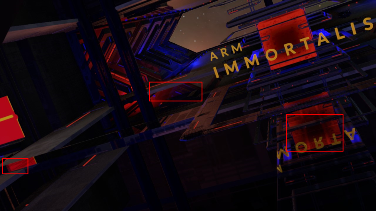

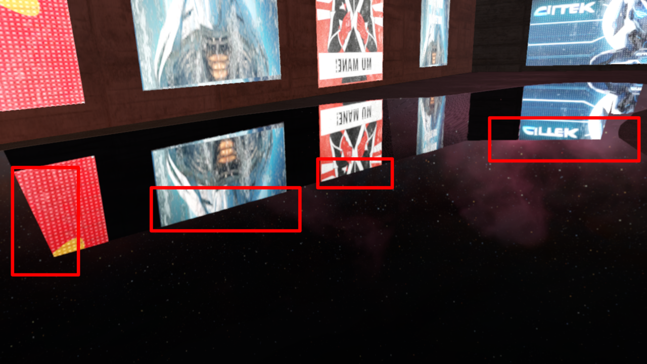

As you can see, reflections are ideal for ray tracing. Other traditional techniques that do not implement ray tracing to simulate this ray in multiple ways, but they produce small artifacts. For example, most games use Screen Space Reflections (SSR).
It is common to find corner cases and bugs on Screen Space Reflection at the same time. This technique is more difficult to implement, requiring more magic numbers. The main limitation of Screen Space Reflections is that they depend on the G-buffer information, so occluded objects and objects outside the view frustum cannot be reflected, causing visible artifacts that are common in current games.
![Example 1: Screen space reflections](https://learn.arm.com/learning-paths/mobile-graphics-and-gaming/ray_tracing/images/reflections_artifacts_1_ssr.webp)
*Example 1: Screen space reflections*
![Example 1: Ray tracing reflections](https://learn.arm.com/learning-paths/mobile-graphics-and-gaming/ray_tracing/images/reflections_artifacts_1_rt.webp)
*Example 1: Ray tracing reflections*
![Example 2: Screen space reflections](https://learn.arm.com/learning-paths/mobile-graphics-and-gaming/ray_tracing/images/reflections_artifacts_2_ssr.webp)
*Example 2: Screen space reflections*
![Example 2: Ray tracing reflections](https://learn.arm.com/learning-paths/mobile-graphics-and-gaming/ray_tracing/images/reflections_artifacts_2_rt.webp)
*Example 2: Ray tracing reflections*
![Example 3: Screen space reflections](https://learn.arm.com/learning-paths/mobile-graphics-and-gaming/ray_tracing/images/reflections_artifacts_3_ssr.webp)
*Example 3: Screen space reflections*
![Example 3: Ray tracing reflections](https://learn.arm.com/learning-paths/mobile-graphics-and-gaming/ray_tracing/images/reflections_artifacts_3_rt.webp)
*Example 3: Ray tracing reflections*
![Example 4: Screen space reflections](https://learn.arm.com/learning-paths/mobile-graphics-and-gaming/ray_tracing/images/reflections_artifacts_4_ssr.webp)
*Example 4: Screen space reflections*
![Example 4: Ray tracing reflections](https://learn.arm.com/learning-paths/mobile-graphics-and-gaming/ray_tracing/images/reflections_artifacts_4_rt.webp)
*Example 4: Ray tracing reflections*

### Reflections with multiple bounces
In the real world, ray lights usually have multiple bounces. You can simulate this behavior by launching additional reflection rays if you hit a reflective surface. However, this will be expensive, and you should evaluate to see if the extra complexity is worth it.
![Example 1: No reflections](https://learn.arm.com/learning-paths/mobile-graphics-and-gaming/ray_tracing/images/reflections_bounce_b_no.png)
*Example 1: No reflections*
![Example 1: Reflections with 1 bounce](https://learn.arm.com/learning-paths/mobile-graphics-and-gaming/ray_tracing/images/reflections_bounce_b_1.png)
*Example 1: Reflections with 1 bounce*
![Example 1: Reflections with 2 bounces](https://learn.arm.com/learning-paths/mobile-graphics-and-gaming/ray_tracing/images/reflections_bounce_b_2.png)
*Example 1: Reflections with 2 bounces*
![Example 2: No reflections](https://learn.arm.com/learning-paths/mobile-graphics-and-gaming/ray_tracing/images/reflections_bounce_a_no.png)
*Example 2: No reflections*
![Example 2: Reflections with 1 bounce](https://learn.arm.com/learning-paths/mobile-graphics-and-gaming/ray_tracing/images/reflections_bounce_a_1.png)
*Example 2: Reflections with 1 bounce*
![Example 2: Reflections with 2 bounces](https://learn.arm.com/learning-paths/mobile-graphics-and-gaming/ray_tracing/images/reflections_bounce_a_2.png)
*Example 2: Reflections with 2 bounces*
![Example 2: Reflections with 4 bounces](https://learn.arm.com/learning-paths/mobile-graphics-and-gaming/ray_tracing/images/reflections_bounce_a_4.png)
*Example 2: Reflections with 4 bounces*
