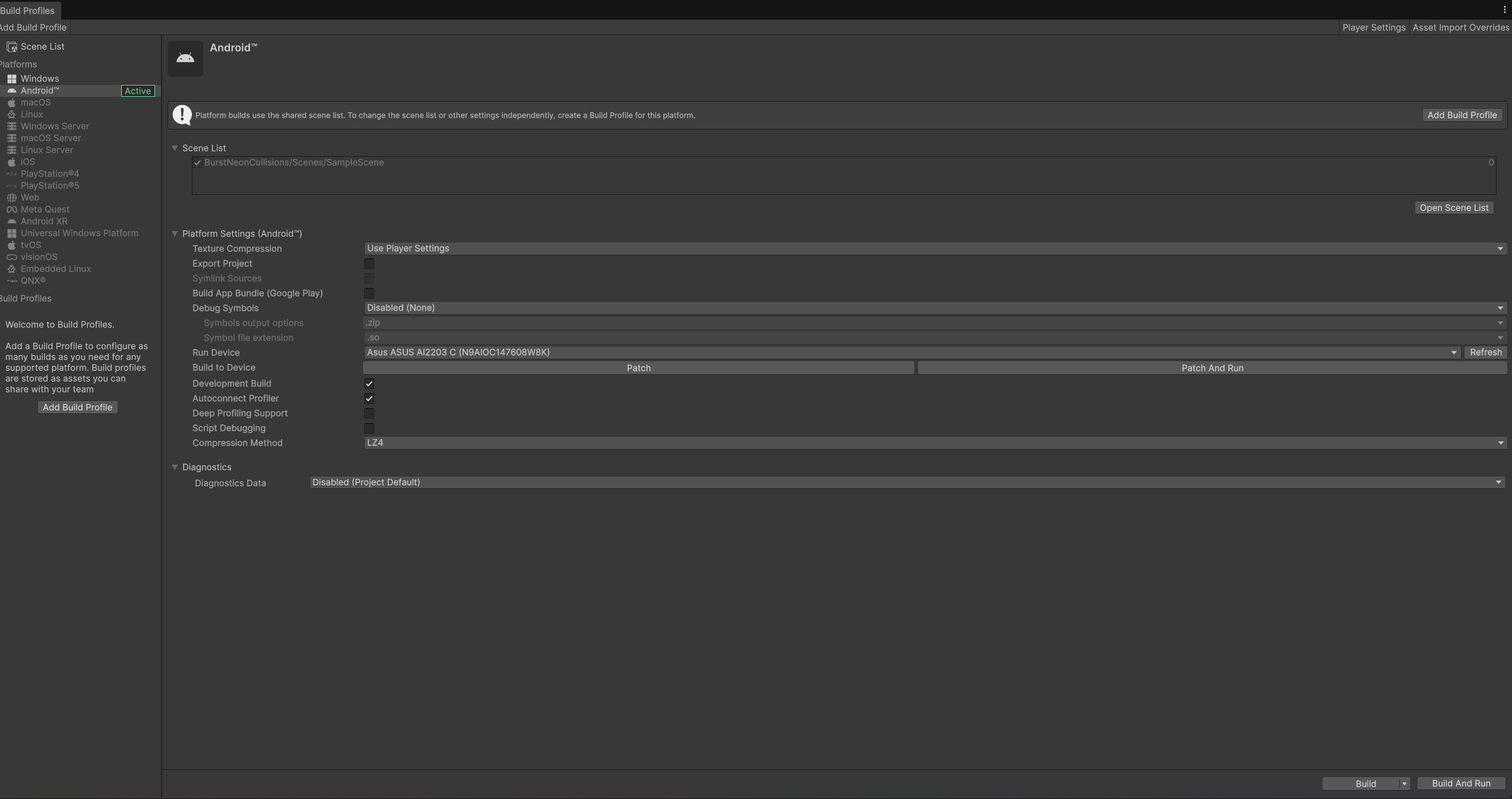

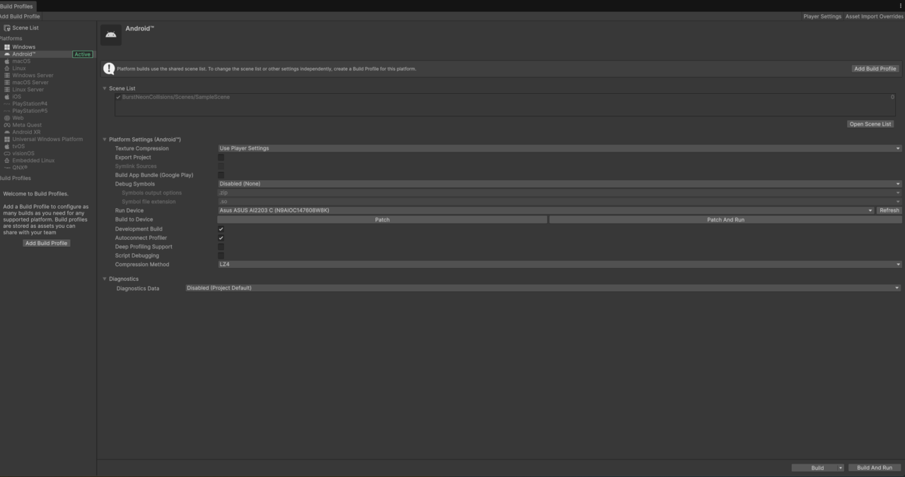

  1. Open the Build Profiles
  2. Ensure Autoconnect Profiler is ticked
    Image Alt Text:Build settings to autoconnect profilerFigure 1. Build settings with connected Android device and Autoconnect Profiler enabled.
  3. Select Build and Run
  4. Choose your save path and name
  5. Wait for Unity to launch the collision sample and auto-connect the Profiler

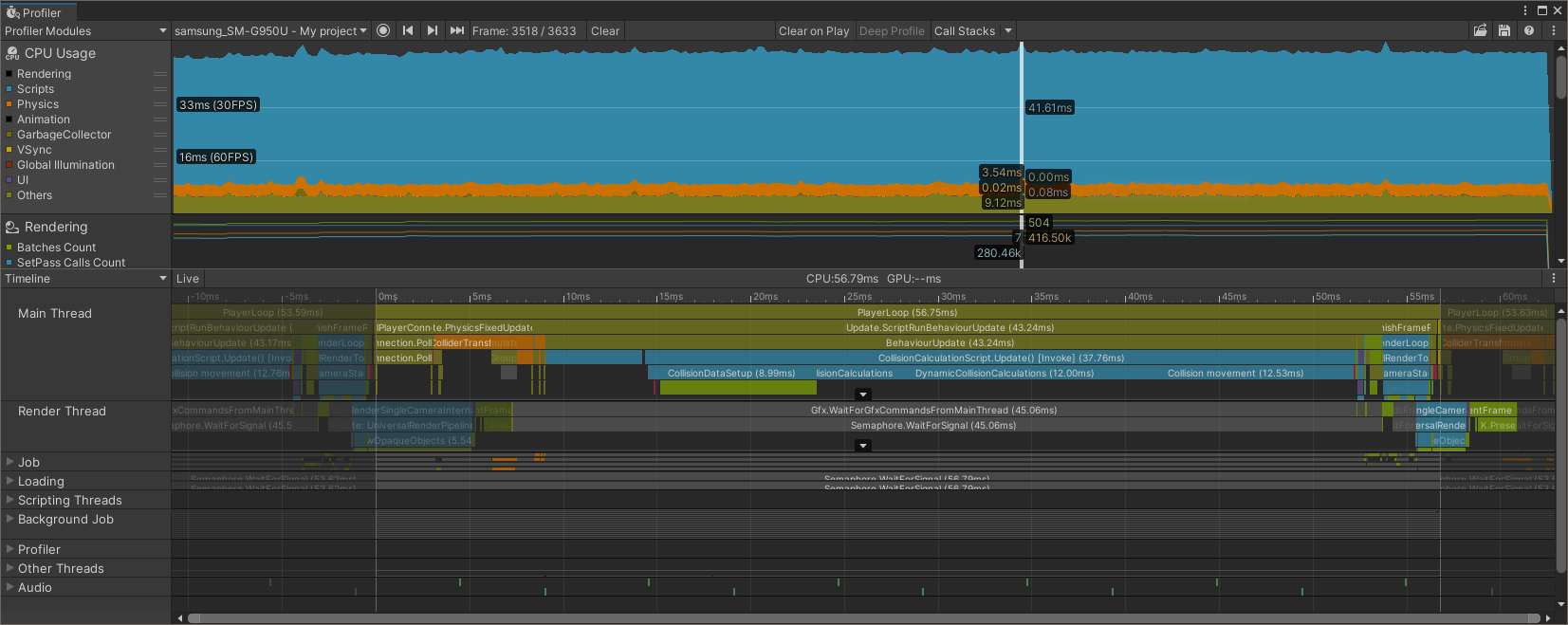

The Profiler window contains a lot of information spread over two main scrollable panels. The top panel CPU Usage shows a graph of usage (in milliseconds) over time. It highlights key areas in different colors.
CPU Usage graph and frame-rate labels
The CPU Usage graph captures profiling data every frame while it is active.
Image Alt Text:Profiler CPU usageFigure 2. The CPU Usage graph with data from the sample collision code app collected.
If you have a performance issue that worsens over time (as with the case of the collision sample), you will see the graph gradually (or quickly) fill over time. Watch the frame rate labels on the left of the graph. These labels mark the Y-axis at set intervals. They show you what CPU Usage would be required to achieve given frame rates. For example, if your CPU Usage remained under 16 milliseconds then as far as the CPU is concerned, a frame rate of 60 frames-per-second (FPS) would be achievable. If the CPU Usage is under 16ms but your frame rate is still lower than expected, that is an indication that the app has performance issues elsewhere, e.g., in the GPU.
The CPU Usage graph can be simplified by turning off areas of measurement that you are not interested in. For example, if you are confident the problem is not related to animation, you could click the Animation entry on the left. This can make the graph a little easier to read and allow you to focus on what matters. Be careful though, you don’t want to make assumptions too early and miss unexpected intermittent peaks.

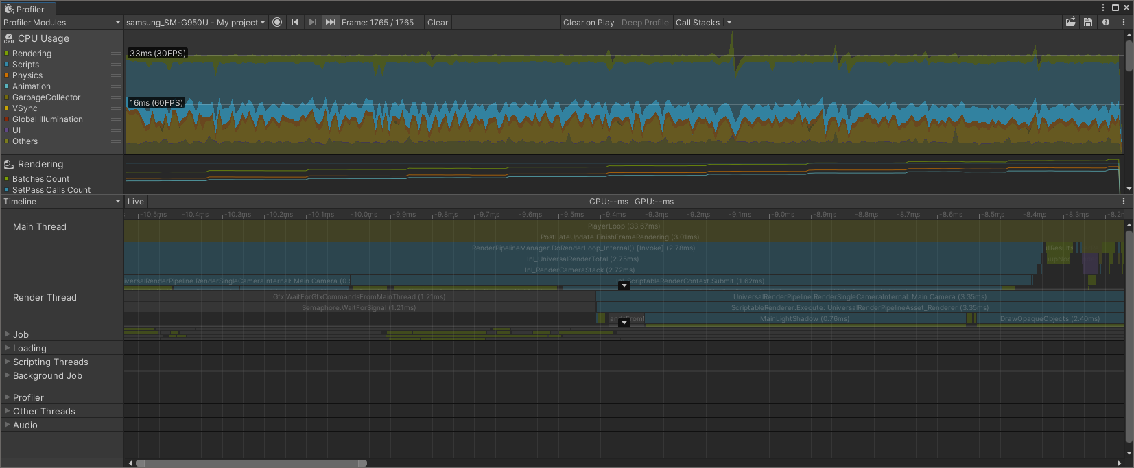

The peaks on the CPU Usage graph tell you where there are particularly high loads. Ensure that the drop-down menu in the lower panel is showing Timeline. Select a frame on your graph where there is a peak or any frame that looks as if it took more time than it should (in this case, all frames look suitable).
Image Alt Text:Profiler selected frameFigure 3. Profiler highlighting selected frame.
The lower panel will show activity from the selected frame. The rows show main thread, render thread, job worker threads (expand Job entry to see the workers and what tasks they performed) and several other areas and job types. The colors of the boxes match those of the categories listed in the CPU Usage panel.
You can expand or shrink the Timeline panel using the scroll-wheel. To pan around, click the scroll-wheel. Do this until you can see the Timeline rows more clearly. Each frame is being shown one after the other, left to right. Your selected frame is brighter than the surrounding frames. You will see in the panel header the amount of time taken by the selected frame (e.g., in Figure 3, CPU 56.79ms). The time axis below the header runs from 0ms (start of frame) for the duration of the frame.
For now, focus on the main thread because it seems to be very busy. The top row says that the PlayerLoop entry is taking 56.75ms. Even if nothing else was running, you would be limited to approximately 17 frames per second (1000 / 56.75 = 17.6). The bottleneck seems to be CPU related.
The PlayerLoop entry on the main thread is an internal Unity engine function, the row below gives a breakdown of the PlayerLoop. If you zoom in close enough you will find many different functions being called related to polling and updating objects. The largest entry (the function that seems to take the most time) is Update.ScriptRunBehaviourUpdate. The label in the box says 43.24ms. Therefore, of the 56.75ms cost of PlayerLoop, the vast majority of that is somewhere in Update.ScriptRunBehaviourUpdate.

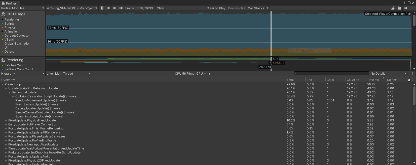

Staying in the lower panel, select the drop-down menu currently labeled Timeline. Change it to Hierarchy mode. You will now see a Hierarchy of functions and profiled areas. Expand the Hierarchy to show PlayerLoop/Update.ScriptRunBehaviourUpdate/BehaviourUpdate.
Image Alt Text:Profiler hierarchy viewFigure 4. Hierarchy view of selected frame.
Under BehaviourUpdate, you will see the custom script CollisionCalculationScript.Update. If you look across to the right, you will see information about the calls to this function. Under the Total column below you will see that the CollisionCalculationScript Update() function took 66.4% of the total of PlayerLoop. Expand CollisionCalculationScript to drill down even further.
