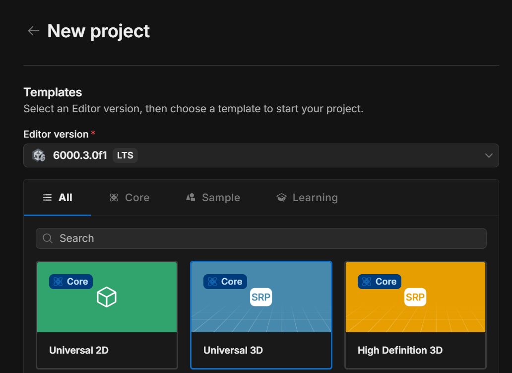

  1. Open the Unity Hub
  2. Log in (if you are not already)
  3. Select New Project
  4. Select the 3D (URP) Core template
    Image Alt Text:Display URP TemplateFigure 1. URP 3D template
  5. Enter a project name (this will be used as the name of the project folder)
  6. Enter a location (the path of your project on disk)
  7. Select Create Project

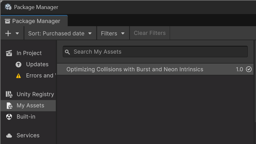

  8. The Unity Editor will come to the foreground and display the Package Manager
    Image Alt Text:Open Project managerFigure 2. Package Manager with asset showing.
  9. You will see the sample project listed and highlighted. Select Download.

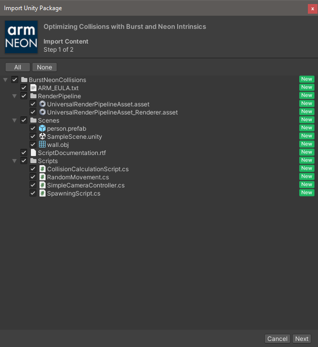

  13. The Import Unity Package window will appear. It allows individual files and folders to be imported or ignored. You will need all of the files in the project. Leave all items ticked and select Next.
    Image Alt Text:Import sample projectFigure 3. Import the sample project using the Package Manager.

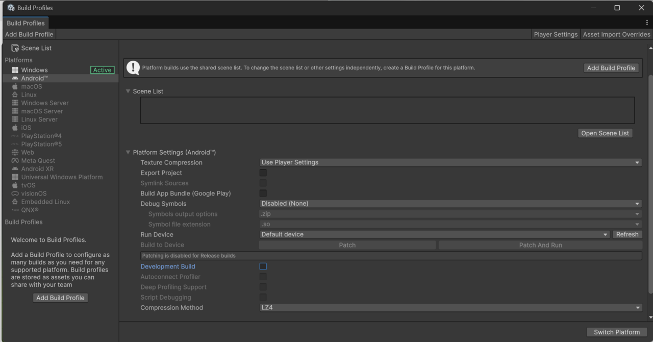

  1. Open the File menu and select Build Profiles
  2. Select Android from the Platform list
  3. Select Switch Platform, as you did in the previous Learning Path
    Image Alt Text:Build-Profile-MenuFigure 5. Build Profile menu.
Unity will take a moment to build the assets for the Android platform.

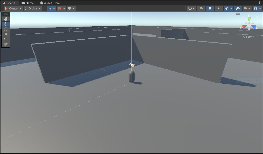

Your Scene view should look something like this:
Image Alt Text:Scene viewFigure 6. Default scene view of the sample project.
If it does not, the next steps should help identify the issue.

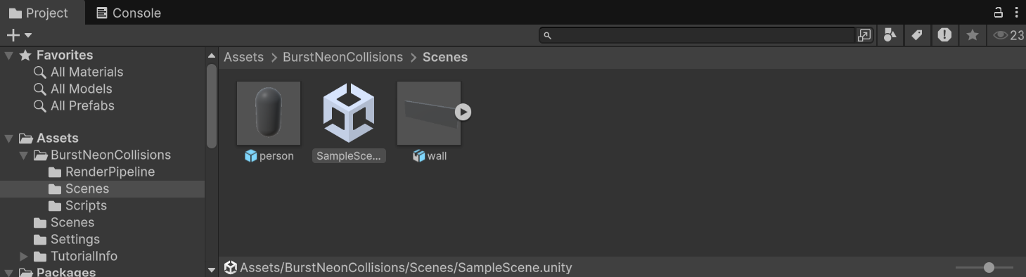

  1. Close the Build Profiles window
  2. In the Project tab (usually at the bottom in the default layout), you will see the list of asset files.
    Image Alt Text:Scenes FolderFigure 7. Assets area
  3. Open the BurstNeonCollisions folder
  4. Open the Scenes folder

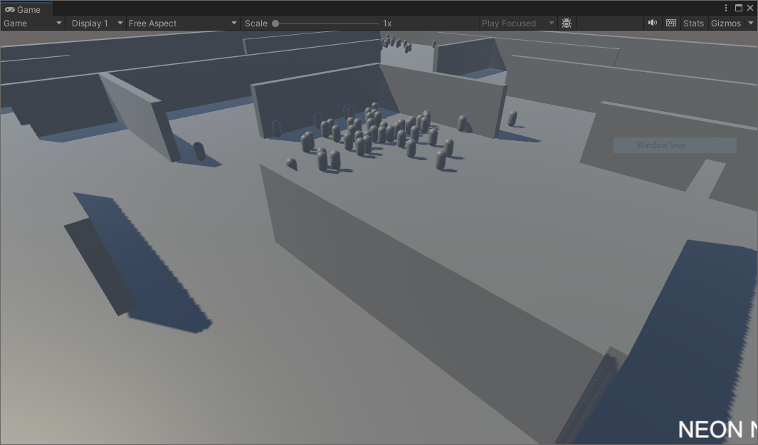

  5. Open the scene called SampleScene
  6. Select the Play (triangle) button to launch the program.
The game will launch, and you will see an empty environment begin to fill with more and more characters (capsules) over time. It will look something like this:
Image Alt Text:Screenshot at runtimeFigure 8. Sample running in Game view.

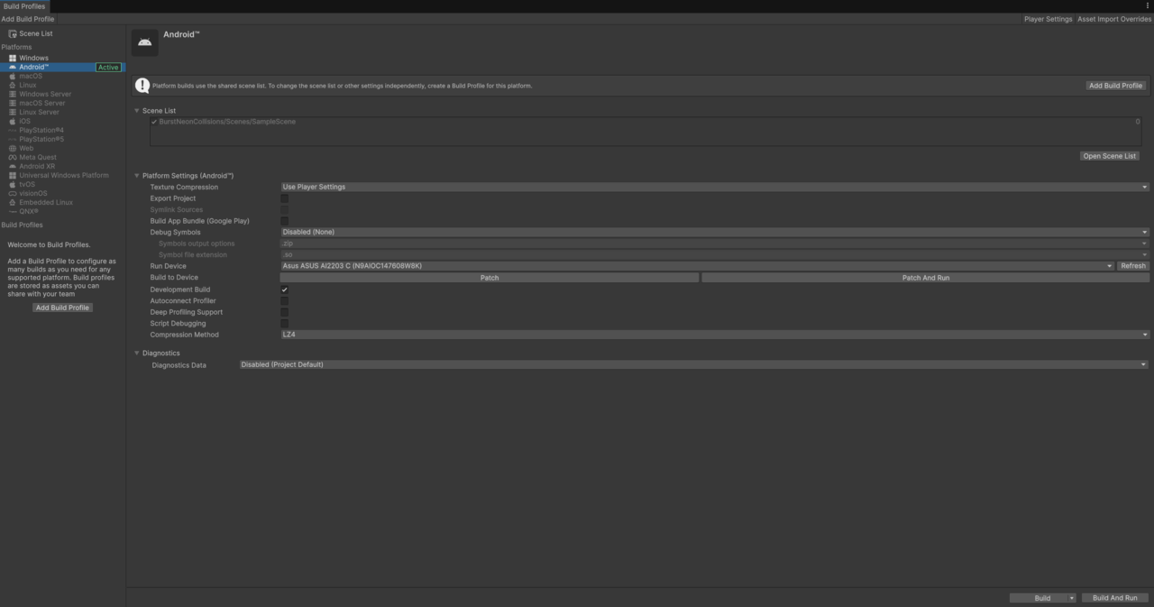

  1. Open Build Profiles from the File menu
  2. Tick the Development Build option
Image Alt Text:Import sample projectFigure 9. Development Build.
  1. Select Add Open Scenes to add the demo scene to your Scenes in Build list
  2. Plug your Android device into your computer
  3. Once recognized, your device will appear in the drop-down menu next to Run Device
  4. The screenshot above shows the demo device selected as the Run Device. You will see your own device listed here
  5. Select Build and Run
  6. Enter a name for the APK (the Android package) and select Save
Unity will take a moment to build the Android version and then automatically deploy it to your connected Android device. Depending on your setup, the build and deployment process may take several minutes.

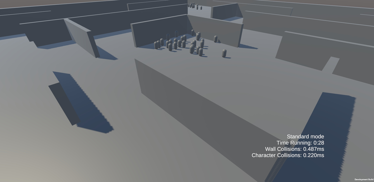

This is an example of what the scene could look like on your device:
Image Alt Text:Running on AndroidFigure 10. Sample application running on Android.
