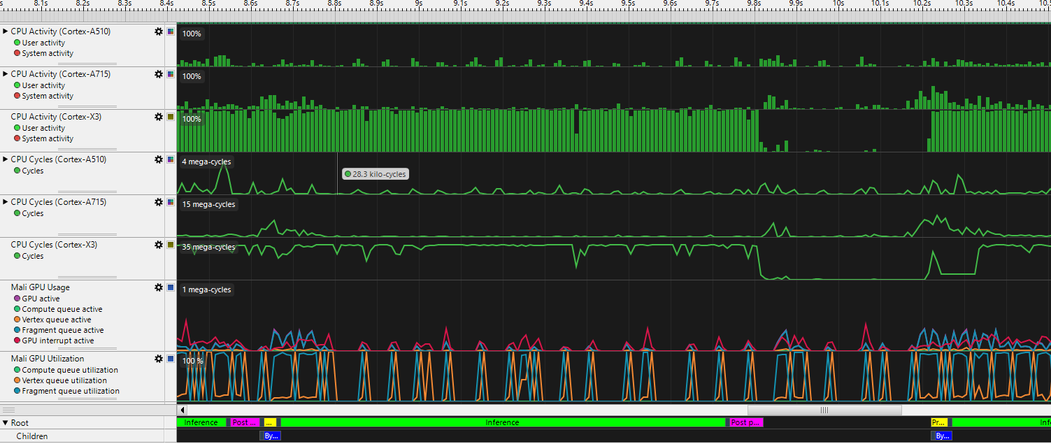

Application profiling can be split into two main types:
  • Sampling.
  • Instrumentation.
Streamline is an example of a sampling profiler that takes regular samples of various counters and registers in the system to provide a detailed view of the system’s performance.
Whilst sampling only provides a statistical view, it is less intrusive and has less processing overhead than instrumentation.
The profiler looks at performance metrics such as memory, CPU activity and cycles, cache misses, and many parts of the GPU.
It can also provide a timeline-view of these counters to show any changes in the application’s performance, which can reveal bottlenecks, and help you to identify where to focus your optimization efforts.
Image Alt Text:Streamline image alt-textFigure 1. Streamline Timeline View

This colored marker with a string annotation will add the string and time to Streamline’s log view, and it appears like the image shown below in Streamline’s timeline (in the example app, Arm NN is not used, so there are no white Arm NN markers):
Image Alt Text:Streamline image alt-textFigure 2. Streamline timeline markers

The example application is fast and simple, and the CAMs do not show a lot of information. In a more complex application, you can add further CAMs, including child-level ones, to give more detailed annotations to show where time is spent in your application. For this example app with its very fast inference, it is best to change the Streamline timeline view scale to 10µs in order to better see the CAM annotations.
Once you have added in useful CAM annotations, you can build and deploy a debug version of your application. You can run Streamline and see the annotations and CAMs in the timeline view. See the Streamline documentation for information on how to make a capture for profiling. After the capture is made and analyzed, you will be able to see when your application is running the inference, performing ML pre-processing or ML post-processing, or other operations from parts of your application. From there you can see where the most time is spent, and how hard the CPU or GPU is working during different parts of the application. From this you can then decide if work is needed to improve performance and where that work needs doing.
