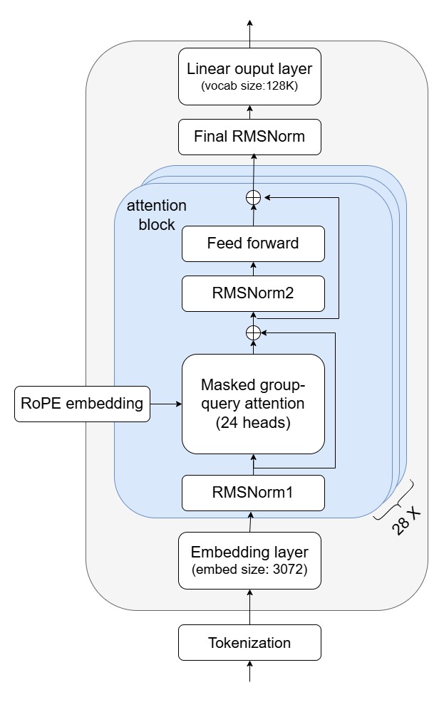

The figure below shows the architecture of the Llama-3.2-3B model: Image Alt Text:Architecture diagram of the Llama-3.2-3B model showing the transformer block structure, including attention heads, feed-forward layers, and the overall token embedding and output projection flow alt-txtArchitecture of Llama-3.2-3B

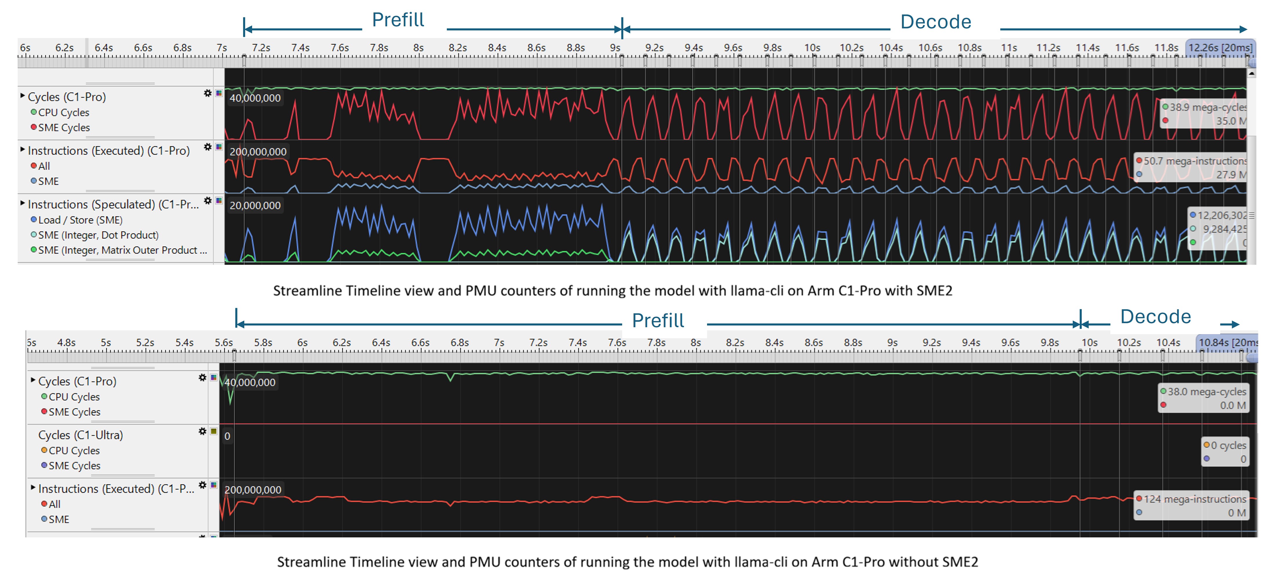

Profile with Arm Streamline (optional)
You can profile the model execution with the approach introduced in Profile llama.cpp performance with Arm Streamline and KleidiAI LLM kernels .
The Streamline Timeline view and Annotate Markers in the figure below show that the token generation speeds up significantly at both Prefill and Decode stage. The PMU event counters show that many SME2 instructions, especially SME2 Integer Outer Product Accumulate instructions at the Prefill stage and SME2 Integer Outer Product instructions at the Decode stage, are used for acceleration.
Image Alt Text:Arm Streamline Timeline view showing side-by-side token generation runs with SME2 enabled and disabled, with Annotate markers highlighting Prefill and Decode stages and PMU counters showing SME2 Integer Outer Product instructions alt-txtCombined Streamline Timeline view with and without SME2

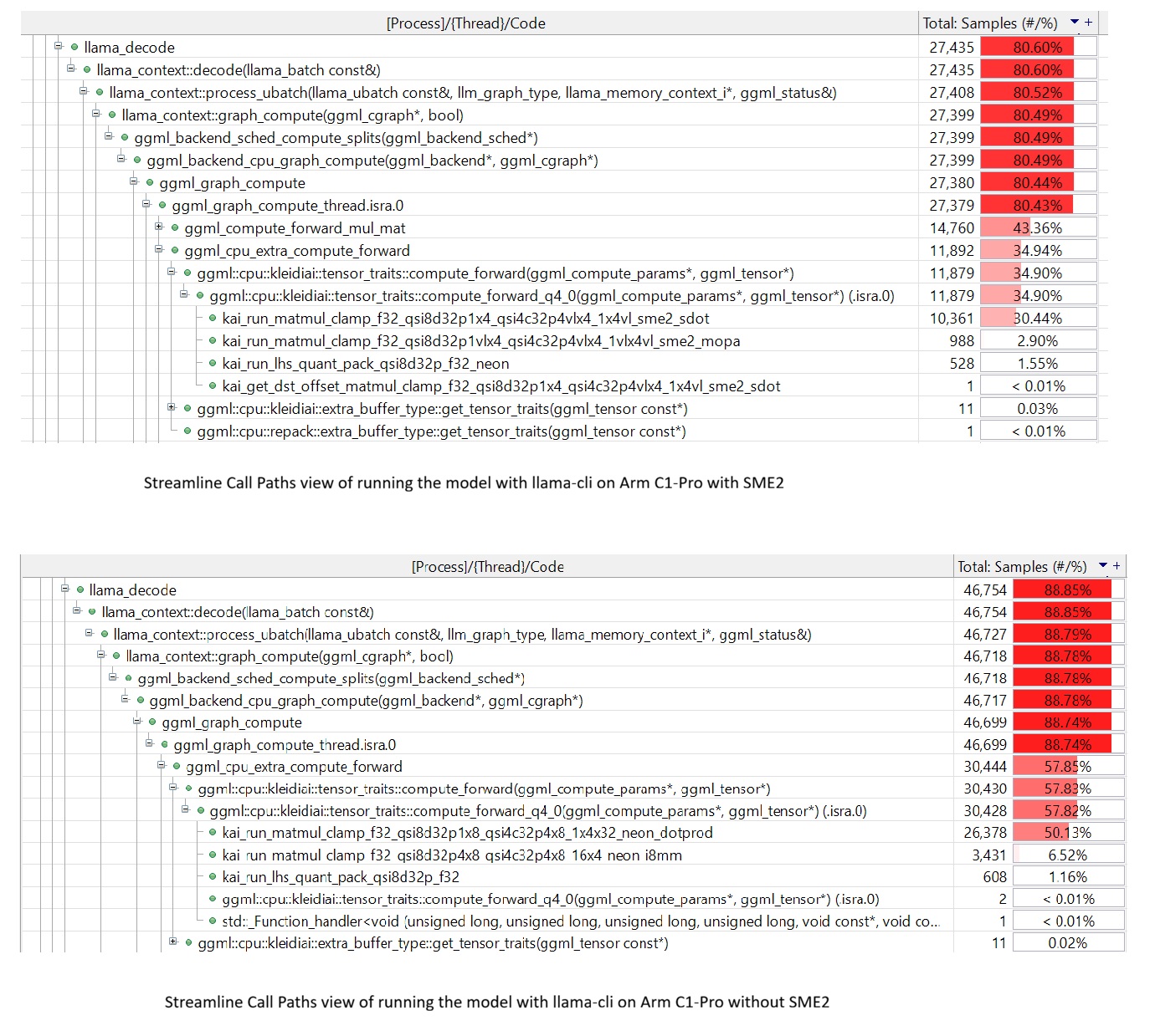

The Streamline Call Paths view below indicates similar speedup, it also shows that DotProd and I8MM KleidiAI microkernels are used instead when SME2 is not enabled.
Image Alt Text:Arm Streamline Call Paths view comparing inference with SME2 enabled against DotProd and I8MM fallback paths, showing the KleidiAI microkernel selected in each case alt-txtCombined Streamline Call Paths view with and without SME2
