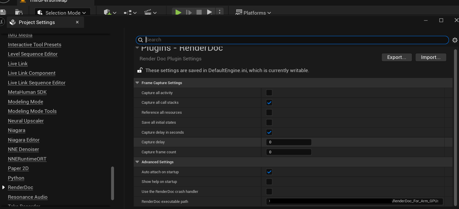

1. Configure the executable path
To enable integration with Unreal Engine:
  1. Open your Unreal Engine project.
  2. Go to Edit > Project Settings > Plugins > RenderDoc.
  3. Under Path to RenderDoc executable, enter the full path to the directory where the qrenderdoc.exe binary is located.
  4. Restart Unreal Engine for the setting to take effect.
Image Alt Text:RenderDoc plugin path setup in Unreal EngineFigure 7: Set the RenderDoc executable path in Unreal Engine plugin settings.

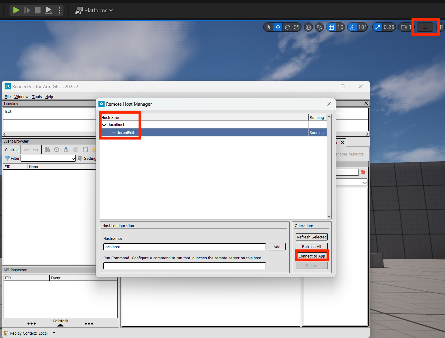

2. Ways to capture
Option 1: Attach to the Running Editor
  1. Launch RenderDoc for Arm GPUs separately.
  2. Go to File > Attach to Running Instance.
  3. A list of running Vulkan-enabled applications will appear. Select the hostname that corresponds to the UE Editor session (with UI) or use Standalone Running App (see image below).
  4. Click Connect to App.
  5. Click Capture Frame Immediately or set up the capture settings otherwise.
Option 2: Use plugin inside Unreal Engine
  1. Open your project and scene where you want to perform a capture.
  2. Click the RenderDoc Capture button in the Level Viewport (see image below).
Image Alt Text:RenderDoc capture button in Unreal Engine Level Viewport, or Attach to Running Instance Figure 8: Two options to capture frames using RenderDoc with Unreal Engine.
