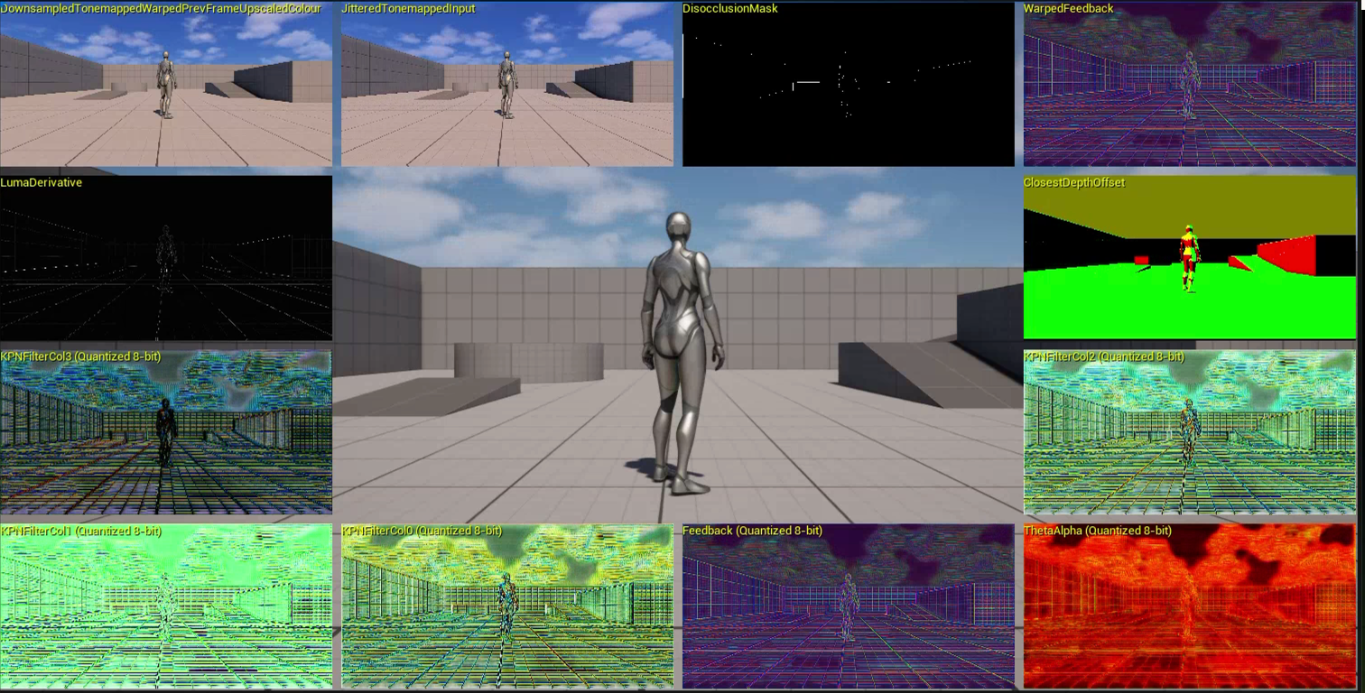

Run ShowFlag.VisualizeTemporalUpscaler 0 to disable the overview. To visualize the NSS model output in real-time, run the following command:
r.NSS.Debug 1
This will add real-time views showing the model’s processed outputs, such as predicted filter coefficients and feedback, as below. In the Wrapping up section , you will find links to learn more about what the debug outputs mean.
Image Alt Text:Debug view of Neural Super Sampling model output in Unreal EngineFigure 6: Visualize NSS model debug output in real time.
