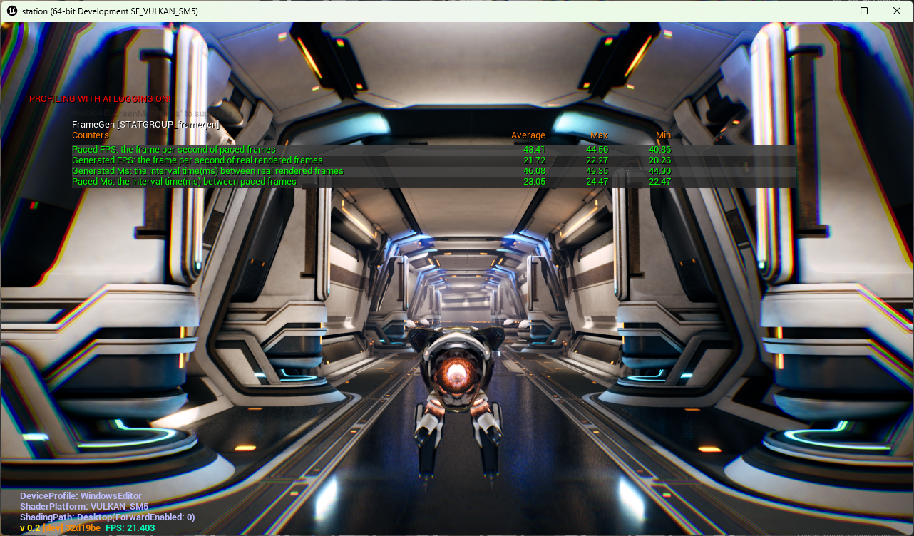

Use stat FrameGen while you tune these values. Compare generated and paced frames to check whether presentation keeps up with frame generation.
Monitor frame generation performance with STATGROUP_FrameGen
NFRU provides the STATGROUP_FrameGen statistics group to monitor frame generation performance at runtime.
Run the following command in the Unreal Engine console:
stat FrameGen
Monitor NFRU frame generation and pacing with stat FrameGen
This command displays runtime metrics such as generated frame rate, generation time, and pacing information. Use these values to assess both internal frame generation performance and final frame pacing.
| Stat | Stat ID | Description |
| Generated FPS | STAT_FrameGen_GeneratedFPS | Frames per second produced by the frame generator. Compare this value with the engine FPS from stat FPS. |
| Generated Ms | STAT_FrameGen_GeneratedMs | Average time in milliseconds to generate an interpolated frame. |
| Paced FPS | STAT_FrameGen_PacedFPS | Presentation-paced FPS after swap-chain pacing is applied. |
| Paced Ms | STAT_FrameGen_PacedMs | Average wall-clock time in milliseconds between paced frame presentations. |
Interpret frame generation statistics
When reviewing statistics, consider the following:
- Generated FPS and Generated Ms show internal frame generation performance.
- Paced FPS and Paced Ms reflect actual presentation cadence after pacing or synchronization.
Typically, Generated FPS matches the engine FPS, while Paced FPS might differ if pacing or synchronization limits the display rate.
