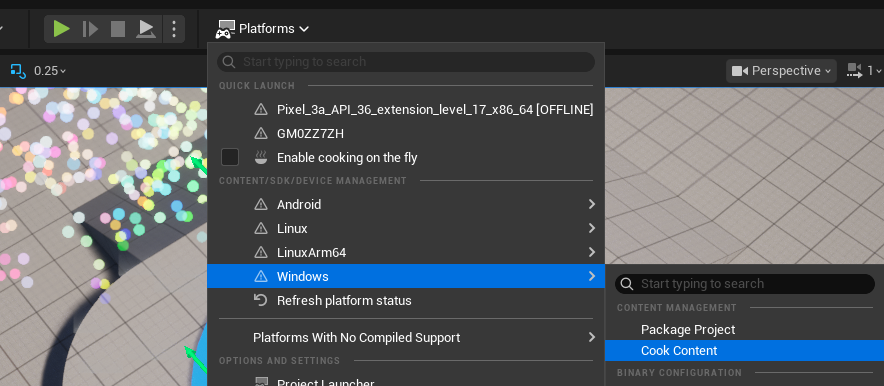

Test in a packaged Windows game
  1. In Edit > Project Settings > Packaging, select the Development build configuration so the game console is available.
  2. In the Editor toolbar, select Platforms > Windows > Package Project and choose an output directory. Wait for packaging to complete.
  3. Run the game executable from the packaged output directory, then open its console and use the NFRU verification commands.
Packaging builds the game and cooks its content for Windows. Use Standalone Game for quick checks. Use a packaged build to validate the output you’ll distribute.

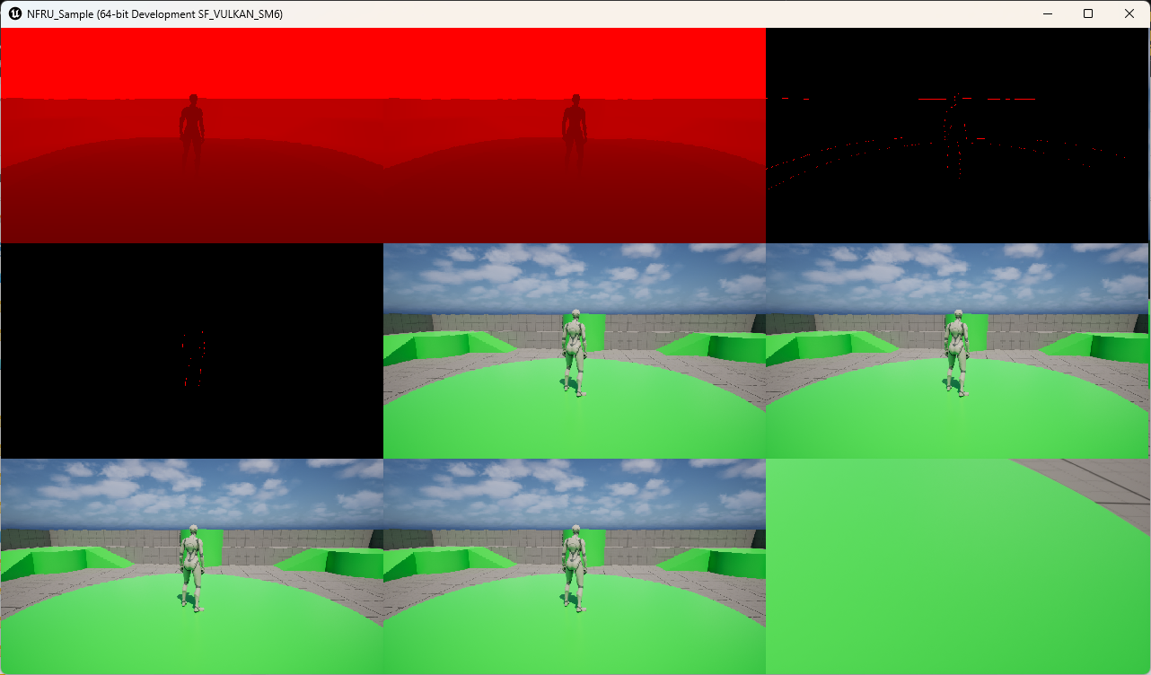

Verify NFRU in Standalone Game or a packaged build
Open the console in the running game and enter:
r.NFRU.Enable 1
r.NFRU.ShowDebugView 1
stat FrameGen
r.NFRU.ShowDebugView 1 displays the NFRU intermediate-buffer grid. If the grid updates during gameplay, NFRU is generating frames. Use stat FrameGen to check frame generation and presentation pacing.
Image Alt Text:NFRU debug output displayed in a running Windows gameUse the debug view to verify NFRU in Standalone Game or a packaged build
Enter r.NFRU.ShowDebugView 0 when you want to disable the debug grid.

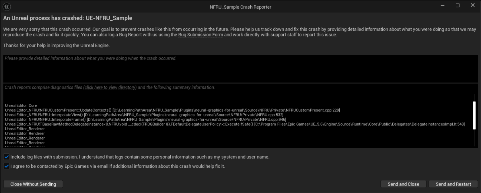

The game crashes after NFRU is enabled
A crash after enabling NFRU can indicate a missing or incorrectly ordered Vulkan emulation layer.
Image Alt Text:Crash dialog after enabling NFRUCheck the Vulkan emulation configuration if the NFRU build crashes
In Vulkan Configurator, check that the layer path points to the plugin’s Binaries\ThirdParty\VulkanMLEmulation\Win64 directory. Enable both layers, place Graph before Tensor, and restart the game.
