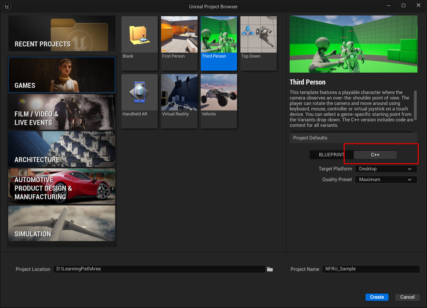

  1. Open Unreal Engine 5.4 or 5.6 and create a new Third Person template project using the C++ option.
    Image Alt Text:Unreal Engine project selection screen showing a C++ Third Person templateCreate a C++ project in a supported Unreal Engine version

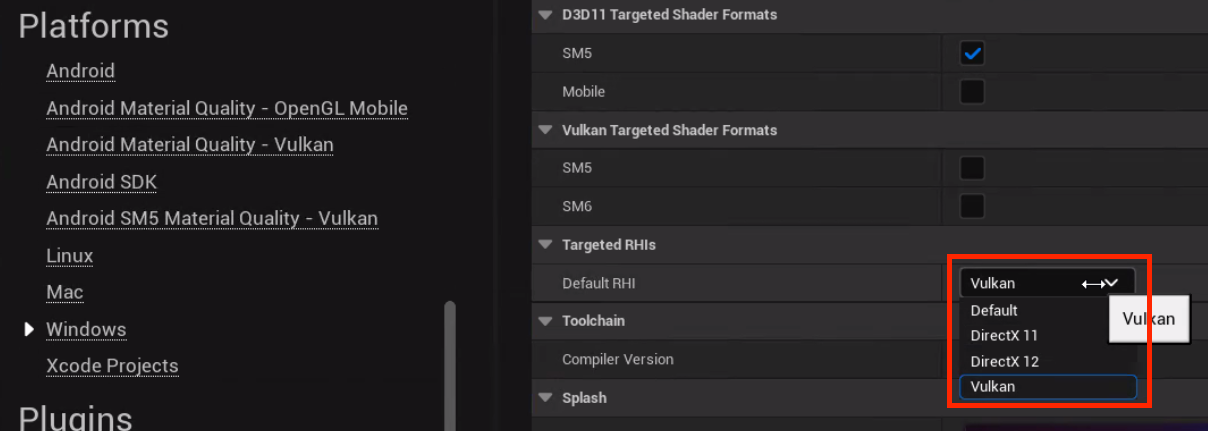

Use Vulkan as the rendering hardware interface
Unreal Engine uses DirectX by default on Windows. NFRU requires Vulkan:
  1. Open Edit > Project Settings.
  2. Go to Platforms > Windows > Targeted RHIs > Default RHI.
  3. Select Vulkan.
  4. Restart Unreal Editor to apply the change.
    Image Alt Text:Project Settings with Vulkan selected as the default RHI under Targeted RHIsSet Vulkan as the default RHI

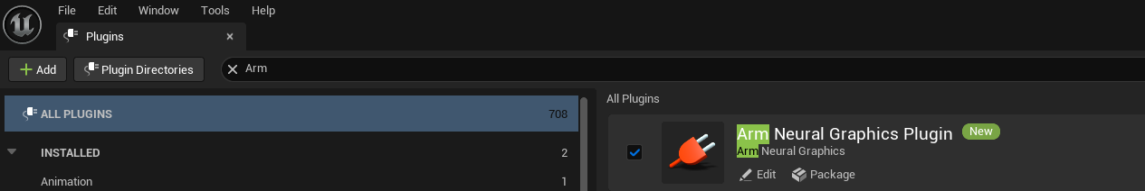

Enable Arm Neural Graphics Plugin
To enable the plugin:
  1. Open Edit > Plugins.
  2. Search for Arm Neural Graphics Plugin.
  3. Enable the plugin if it is not already enabled, and restart Unreal Editor if prompted.
Image Alt Text:Unreal Engine Plugins window filtered for Arm, showing the Arm Neural Graphics Plugin enabled with its checkbox selected. This confirms that the plugin is ready to use in the project.Arm Neural Graphics Plugin enabled in Unreal Engine

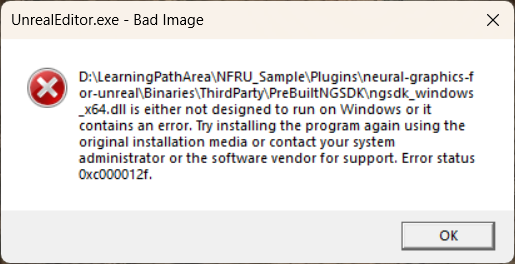

“Bad Image” error for ngsdk_windows_x64.dll
If Windows reports a “Bad Image” error for ngsdk_windows_x64.dll, check that you copied the complete neural-graphics-for-unreal folder from the cloned repository. Do not mix plugin files from different revisions or Unreal Engine versions.
Image Alt Text:Windows Bad Image error for the Neural Graphics SDK DLLA Bad Image error can indicate missing or incompatible plugin binaries
Replace any incomplete plugin copy with the complete folder from the clone, regenerate the Visual Studio project files, and rebuild the solution.
